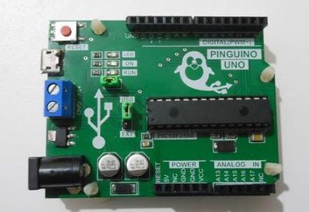

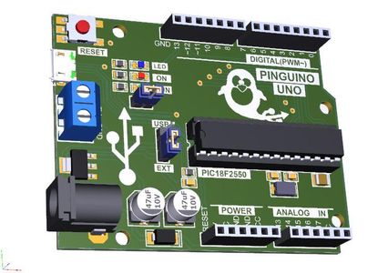

Introduction: Pinguino UNO Rev2 SMD
Development board based on the PIC18F2550, programmable in Arduino language and with the same pin distribuition than the Arduino Uno
Main Features
  • Open Source Programing by Pinguino IDE
  • Works with the same Arduino Language
  • 17 digital pins / 5 analog pins / 2 PWM pins
  • Same dimensiones than the Arduino UNO
  • Same pin distribution (digital and analog) than the Arduino UNO
  • Led SMD test in board
  • We can supply the board with USB or External power supply from 9-12V

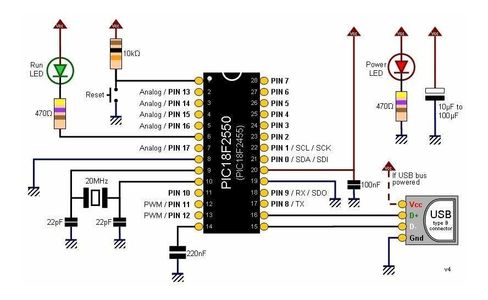

Step 1: Basic Pinguino Schematic Circuit
In the bellow picture We can see the minimal connections necesary to made our board work, according to it, We can made changes and build your own board for specific projects.
Pinguino UNO Pic 18F2550 Schematic
Schematic Diagrama Pinguino based on Pic18f2550 You can get the schematic diagram here:
https://github.com/Arduinolover-Hub/Pinguino-UNO-Rev2-SMD
For the External Supply from 9-12V, the board use the chip 1117 -5V and 1117-3.3V, with the DC Jack conector we can power on easily our projects.

Step 2: PCB LAYOUT
Before We continue with the PCB layout, it is important to indicate that You can use any software for PCB Desing, believe me there are many options, even if you use the best software it will not mean that you are the best pcb desinger, so in this case We are going to use The Altium Designer highly recommended if you want to enter in the pcb design world like a professional.
So after We finished and check our schematic circuit We need to switch from schematic to PCB layout. We can see the PCB with the Ground Plane, this helps for noise filter on the pcb. Also is important to remember that in the case of the microcontroller is necesary to place the crystal and the capacitor the closest possible.
Here after we finish the pcb layout We can get the Gerber files, there are two kind of gerber files we have to pay attention to it, the first GerberX2 and the other Gerber RS274X, most of the manufacturer use the second one Gerber RS274X, in some software we will just GerberX2 and Gerber (In the case of Altium Designer).
You can also download the Gerber Files: There are two kind of gerber files we have to pay attention to it, the first isGerberX2 and the other Gerber RS274X, most of the manufacturer use the second one Gerber RS274X

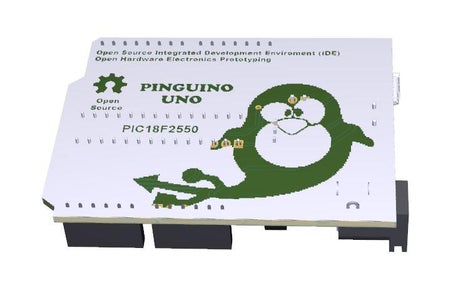

Step 3: ​3D MODEL
One of the features of Altium Designer is the 3D visualization, the 3d visualization is important and it give us the posibility to see and check our PCB and how it would be in real, also it can show us the components distribution and dimensions. Before I did not consider this feature so important, but the 3d visualization can show us if our footprint dimensions are ok, if all the components will be places without touching each other by mistake.
► Also very important to remember, if you are going to add 3d models, be carefull that you add in the Step AP214 format, the others extensions and formats can not work correctly.
The 3d visualization can show us if our footprint dimensions are ok, if all the components will be places without touching each other by mistake.

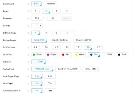

Indicate the features
After the upload of our gerber files, We need to indicate the features of the board, in the next picture you can see the options available.

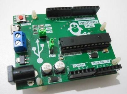

Receive your PCB
Days later, 7 days or few more, according to your location and custom broker process, You will receive your pcb prototypes.

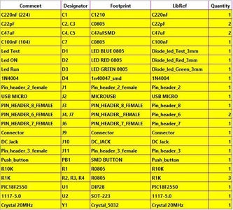

Step 6: Building the Pinguino UNO
In this post you will find the components necesary to build the pinguino Board and also the components are very easy to get. Common components that we regulary use for electronics projects.
You can get the BOM : HERE
