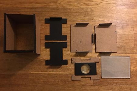

Step 1: Creating Pieces
Get the given pieces laser cut, stick the given group of pieces together to create the numbered parts in the exploded drawing.
Step 2: Assembly
Once you have the pieces in the exploded drawing bring them together in this order:
1. Take pieces 1 and 2 and bring them together by aligning the circles
2. Take pieces 3 and 4 and add them to top and bottom of the previous piece you created
3. Take the lens and place it in the center hole
4. Take pieces 5 and 6 and bring them to the sides
5. Take place 8 and place your joined box into the bigger one
6. Place the frosted glass (piece 9) into the rails at the back
7. Congratulations! You completed your camera obscura. Now point the lens at something you like and take a photo through the frosted glass, or you can use and Iscan to capture the image projected onto the frosted glass. Slide the boxes to get a better focus.
