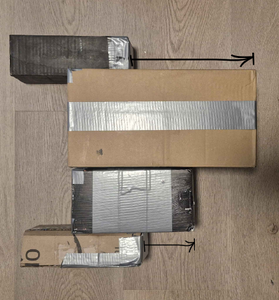

Two pinhole cameras were created, one larger than the other. Both models follow the same design process and are built with a cardboard box. A hole was punched at the center of one end of the box. The other end was cut out, such that a smaller, open-ended cardboard rectangular tube could be slid into the box.
The sliding mechanism allowed the focal length of the camera to be adjusted. One side of the rectangle tube was then taped over with tracing paper, so that the image may be projected onto a surface. The interior of the cameras were painted black as well to minimize any unwanted, internal diffraction of light.

The above images obtained from the pinhole cameras were the images that had the sharpest focus and obtained experimentally by adjusting the sliding inner rectangular tube. It was found that increasing the focal length resulted in larger but darker images (field of view narrowing), while decreasing the focal length made the image smaller but brighter.

Given the general formula for the diameter of the aperture for a pinhole camera and applying it to the smaller versus larger model, it can be seen that as focal length increases, so does the diameter for the optimal pinhole. A larger camera will typically have a longer focal length and a smaller camera will have a shorter focal length. This is proven in the image below, where the focal lengths of both cameras are indicated by the black arrows.
As such, a larger pinhole will work best for a larger camera, and a smaller pinhole should work best for a smaller camera. In practice, this was found to be the case. When the same size pinholes were made for both cameras, the images in the smaller camera were blurrier and the pinhole of the smaller camera had to be partially covered or minimized by tape in order to sharpen the image. The optimal focal lengths for the pinhole size in the following image were found by experimentally adjusting the cameras and marking where that point for optimality was.
