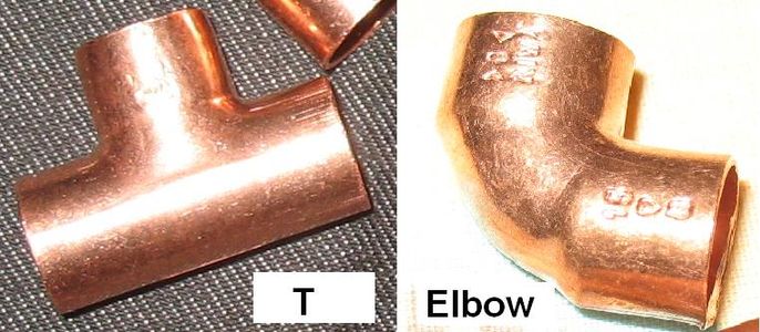

2. 6 elbows that fit exactly on the pipe ( first picture)
3. 2 T connector that fit exactly on the pipe (first picture)

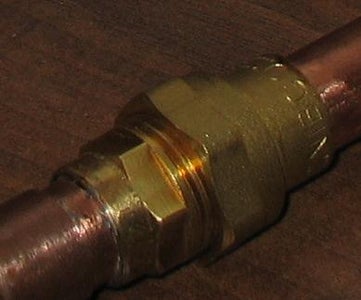

5. a brass connector that fits on the pipe ( second picture)
