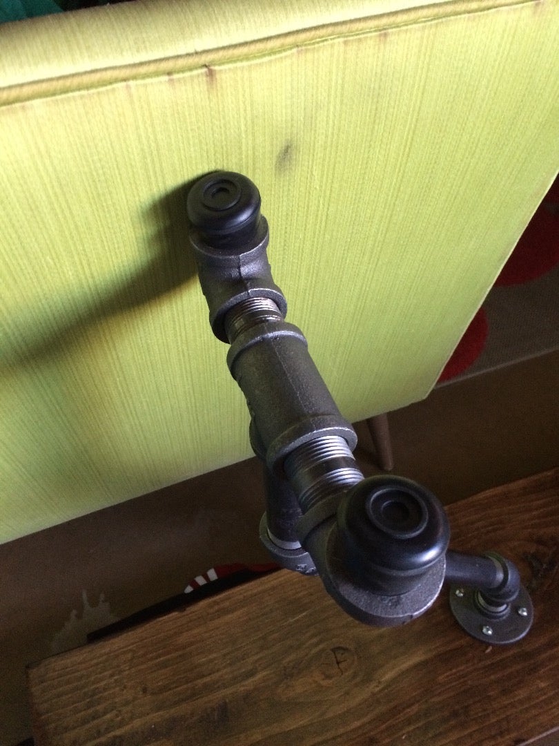

I went to my local hardware store and just started playing with the pipes in the aisle to find a configuration that I liked. I settled on using 1" pipe. I just liked how sturdy it looked and felt, but you could easily use ¾" or even ½". Steel plumbing pipe can be a but pricey, so choose how complicated you want to make your legs carefully. I've labeled the image with each piece I purchased. Remember two multiply this by 2, since there are 2 legs to this thing! Tighten as best you can all the fittings before attaching to the wood.

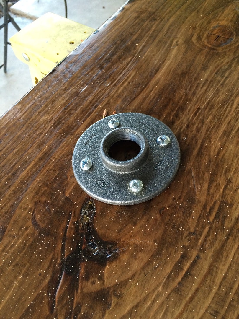

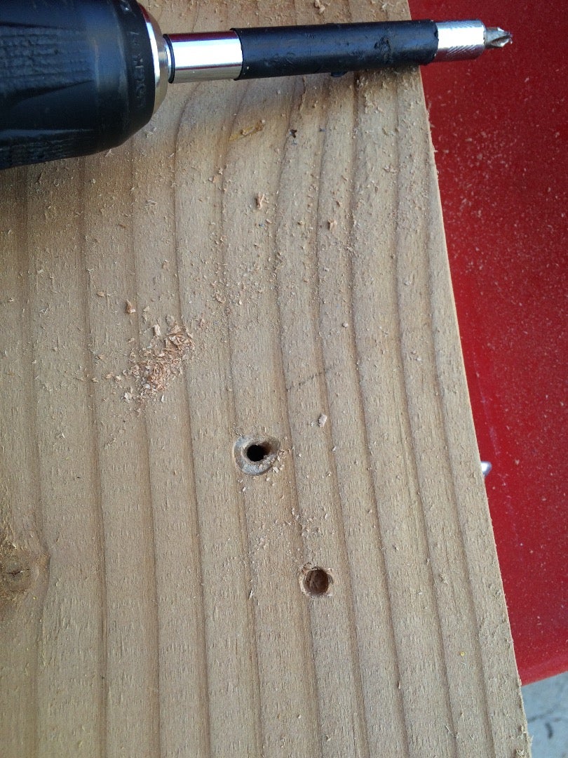

I measured the length of the piece of wood to get an exact measurement, and divided that number by half. This gave me the middle of the board at 3' 5 ⅝". I then halved that number and measured from each end of the board to get the position for placing the legs (basically dividing the board into 4 sections). I placed a small mark on the spot and then removed the pipe flange piece from the end of the first leg and positioned it where I wanted to drill pilot holes for my screws. I tested the drill bit first on a scrap piece of wood that had a similar depth so I could mark the bit with tape and make sure I would not drill through my nice piece of wood. I then used the holes on my pipe flange as a guide for my pilot holes. After drilling the first hole I went ahead and screwed in my first screw. This would help ensure the flange did not move when I drilled the second hole. I drilled a second hole on the opposite side of the flange from the first hole and then place my screw. The flange was now secure and went ahead and drilled and screwed in the final to holes. Do this for both sides.
Next, you simply screw the legs back into the flange. Tighten as best you can so they are in the right orientation, but rigid enough not to move when bumped. This may take a little elbow grease.

This is an optional step, but if you have a nice floor, which I don't actually, you may want to protect it from scrapes by adding these rubber leg tip covers. They are pretty simple to install, place into the 90 degree turn and hit with a hammer until you get them in to a depth you want.
