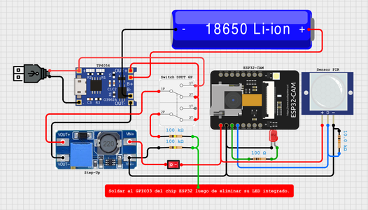

Hardware
  1. 1x ESP32-CAM board and external antenna (optional).
  2. 1x PIR motion sensor HC-SR501.
  3. 1x Step-Up MT3608 DC-DC
  4. 1x Charging module TP4056.
  5. 1x Battery holder 18650.
  6. 1x 18650 battery.
  7. 1x DPDT 6P switch.
  8. 1x LED diode.
  9. Resistors 100 kohm, 10 kohm and 100 ohm.

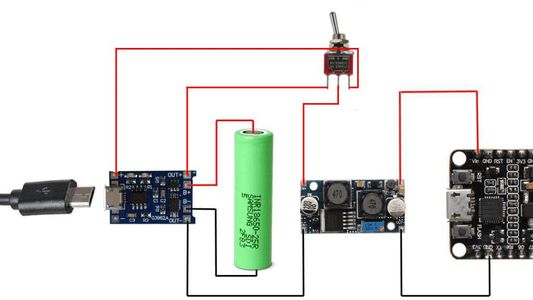

Step 6: Considerations
⚡ Switching between external power supply and battery
Circuit to switch the power supply between the battery and an external 5V source.
⚠️ If the device is connected to an external power supply, it is recommended not to use the battery simultaneously. The TP4056 module is not designed to charge the battery and power the device at the same time, which could cause overcharging and be dangerous. Use the battery only when an external power supply is not available.

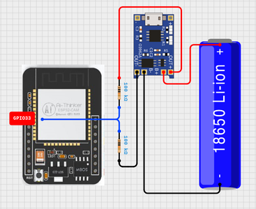

🔋 Battery level
⚠️ Using GPIO33 to measure battery level on ESP32-CAM
On the ESP32-CAM board, only the ADC2 pins are available externally. However, the ADC2 pins are used internally by the Wi-Fi controller or by the microSD, so they cannot be used for analog readings while Wi-Fi is enabled.
By default, the GPIO33 pin which is ADC1 is connected to the on-board integrated LED. To use this pin as an analog input to measure the battery level, you must desolder the integrated LED that is connected to GPIO33. This way, you will be able to connect the resistive divider for battery voltage measurement to this pin.
