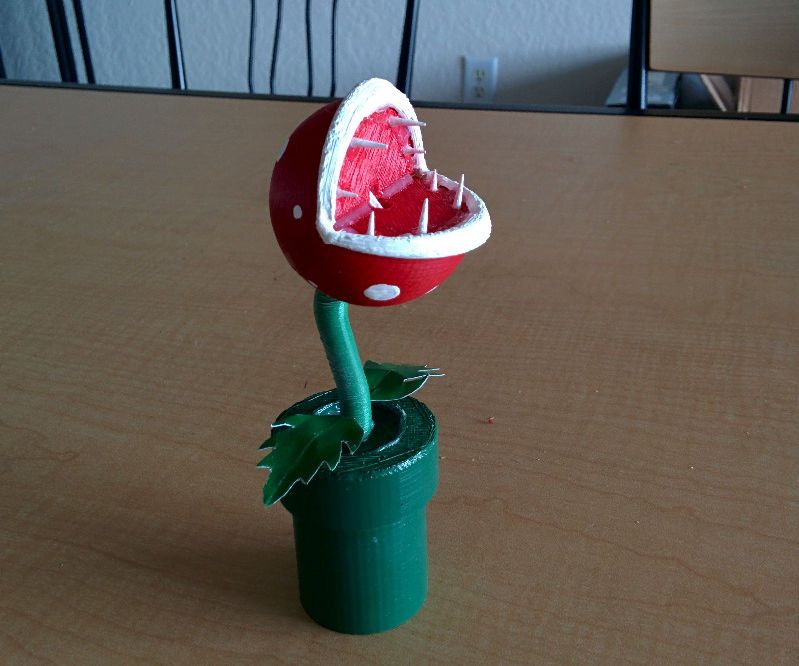

Introduction: Piranha Plant
This instructable was created in fulfillment of the project requirement of the Makecourse at the University of South Florida (www.makecourse.com)
Now, most of us will recognize the one of the most famous plants from the Super Mario Bros. Series, but for those of us who don't it is basically a plant that pops out of the ground or a pipe and usually spits fireballs at you. Here we're going to show you how to 3D print one of your own, and make it so that it can shoot at your nearest plumber.

The pipe is really easy as far as circuitry goes. Get the HC-SR04 Ultrasonic Ranging Module and just tape it to the openings, you can glue it if you want but I used tape. Connect either the IIC cable or 4 female-female jumper cables and remember to label them (The pins are labeled on the USR module).
Now place the Base/Vine combination onto the Pipe. You can choose to glue it if you so desire at this moment.

Now since everything is done, we can start closing things up. Screw the top of the electronics enclosure and begin to glue the Pipe on top of the enclosure. Make sure to hide all the wires.
Now you can glue the Vine to the Pipe if you haven't done so already.
Wait for the glue to dry, and now you're done!
Step 16: Plug and Play
Since the program has already been uploaded, now whenever you plug in the Piranha Plant to a USB it will automatically start taking distances and opening it's mouth if anyone is within range. Mind you, you will have to manually out in the "fireballs" into the pistol in its mouth if you want it to fire. And you have to take off the safety if you want it to fire.
