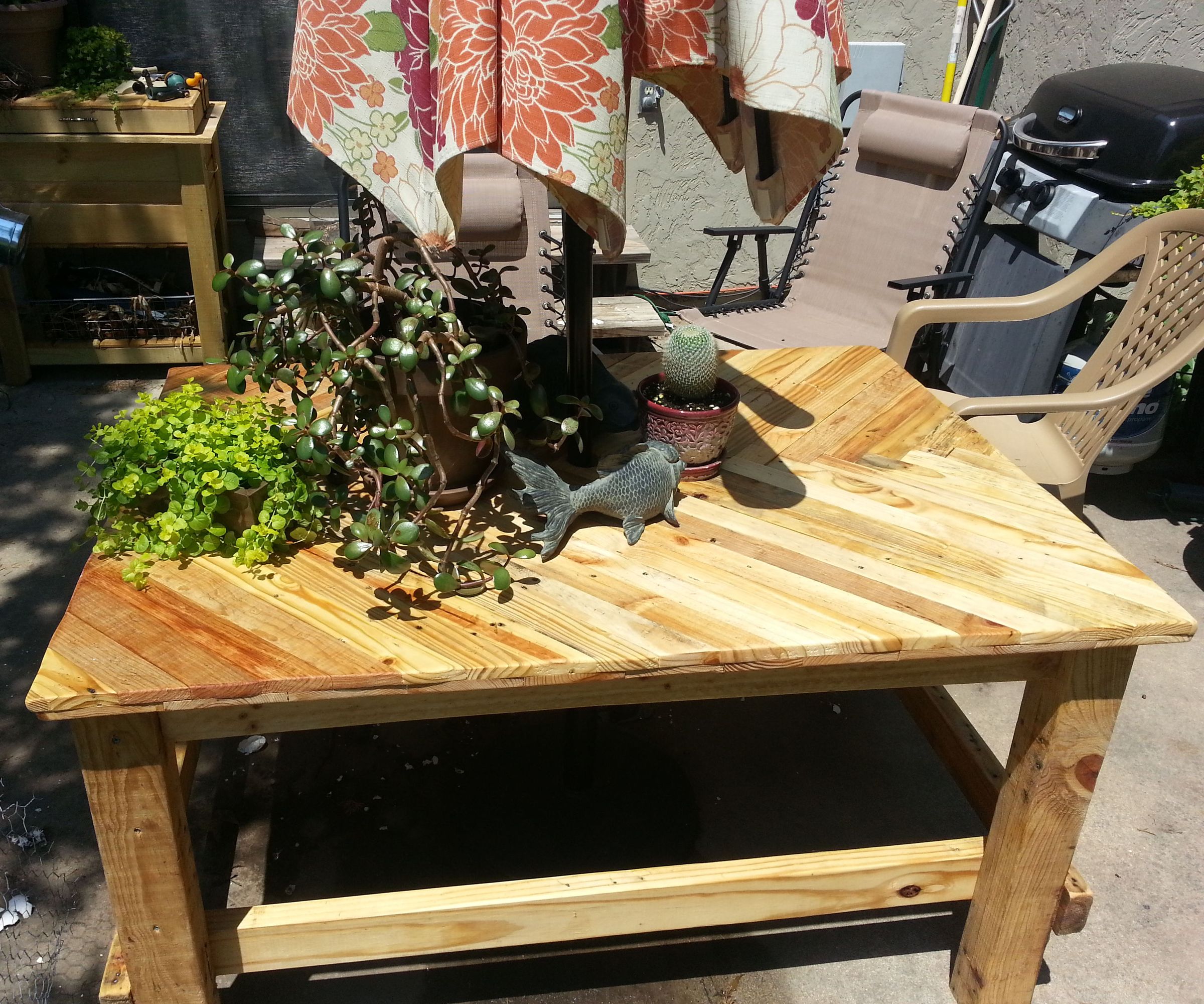

- I wanted to keep as much of this chest made out of stuff that I already had. I had a little bit of stain left over from my pallet wood table build. It's a natural finish and I liked the way it looked on my table. There was less than half a can left so I figured I could easily stain the chest with it.
