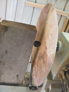

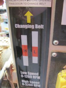

Before mounting the timber on the lathe it needs to be set up correctly. My lathe has a speed dial and 2 belts. For big pieces you need to put the belt on the low setting. This gives the lathe more power at compared to having it running at the same speed on the high belt.
For turnings this big you will need the outboard attachments. For my lathe this was a $100 investment. This comes with a bed extension and extended tool post.

Attaching the timber. For shaping the back I just used my face plate with 6 screws. The timber was cut round to make the turning easier and allow me to increase speeds quicker

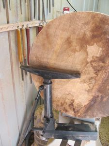

When turning platter I prefer having the tail stock applying pressure. The 4 jaw chucks are strong but when you are working that far out from center the leverage can pop it out with too much pressure. This is an additional safety measure that has kept me a lot safer.
With the outboard extension you can not get a tail stock. So I made my own. Its a solid bit of spotted gum that I have cut a tenon in so it slots into the bed. There is a threaded rod with a bolt and a shaped metal washer to clamp to the bed. There is an old live center that had been perfectly positioned by using the head stocks center to mark it out. Its a simple design but has to be done accurately.
By pushing this stock against the timber and locking it off I get adequate pressure.

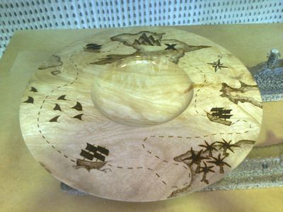

Step 5: Design

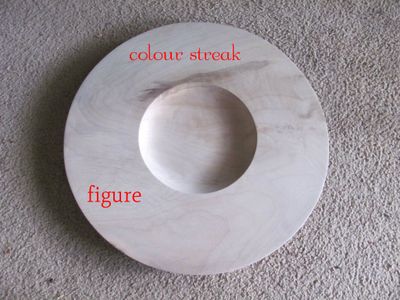

I looked at many maps and got inspired for designs. I found things that I wanted to include such as boats, sharks, compass and palms. With this I created a sketch which then changed a bit but it was enough to start making plans. The main reason this changed was the timber. With the grain of the timber, this is a canvas that can dictate where things go in your design. There were 2 features that affected my design. A section of high figure and a small coloured streak. The figure looked like rough waters so that is where I placed the sharks. I worked around the colour streak and turning it into part of the island. From there I put everything else in, sketching it with pencil.

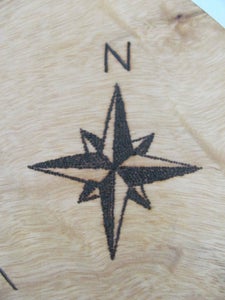

Step 9: Dotting With a Point
This can end up quite accurate but is very tedious so get comfortable and take your time. Try and keep even pressure. The harder you push, the bigger the dot. With this technique you only get black so shading isnt an option. This was great for the compass and some outlines.

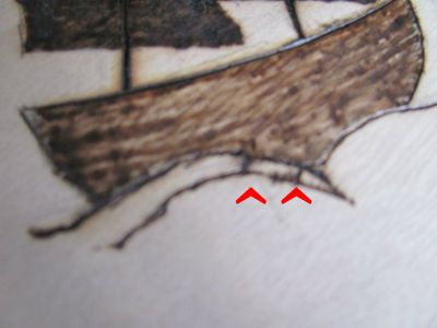

Step 12: Mistakes

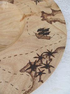

Mistakes are hard to remove. I accidentally hit open space (pic 1). I sanded most of it out but there is still a faint line.
Another spot I slipped I was able to cover up by adding waves (pic 2). This is better as it doesnt create hollow from sanding and if done will it can look completely intentional. It also tests your creativity.

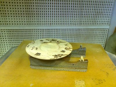

Step 13: Finish
Lightly sand and erase all pencil marks. Make it as crisp as possible.
I used lacquer to seal it well with out smudging the charred marks. Between coats, cut it back to remove dust that is caught up. I did 3 coats and that gave me a great finish.
