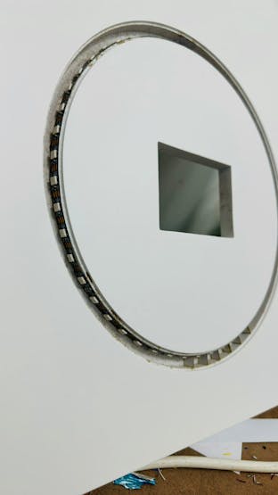

Pixel Chase presents a simple yet addictive gameplay experience. You'll see four LEDs arranged in a circle. Three will remain stationary, while the fourth will continually move around the perimeter. Your objective? Time your button presses perfectly!
  1. Start the Game: A single press of the button initiates the challenge.
  2. Capture the Pixel: As the moving LED ventures inside the stationary circle formation, press the button again. Capture it at the right moment to score.

  2. Neopixel LED Strip: You'll need a 60 LED/m Addressable LED Strip (Neopixel) with 5v Input voltage. These will be arranged in a circular pattern to create the visual elements of the game.

  8. Enclosure: An enclosure can be used to house the components and give the game a more finished appearance. I'm using a structure made by CNC Engraving an MDF wood piece. My colleague Praveen designed the file for CNC engraving Using Solid Works Software. You can Design your enclosure and 3D print it if you don't have access to a CNC Engraving Machine. I will attach the Solid Works file for you if you want to use the same design as me.
  9. Diffusing Top Cover: I used a Light pass Acrylic Sheet with 2 mm thickness cut using laser machine. Also I used small PVC Pieces to separate individual LED pixels.

  2. LED Strip: Connect the data pin of LED strip to GPIO27, +ve to 5v and Gnd to Ground of ESP32. Be mindful of the Data flow of the Neopixel strip should be as per the arrow mark in the LED Strip. Refer the Connection Diagram if you have any doubts.
  3. 5vAdapter: To power up the whole LED strip and ESP32, I'm using a 5v 2A power adapter, I cut the wire and added a JST connector, so that I can connect easily.
