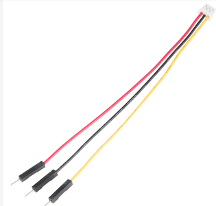

  • 3 basic breadboard jumper wire (male to female)

Step 1: Connections
. NeoPixels are very easy to connect. Our game requires just three connections:
  • GND - ground
  • Positive supply 3V (in the case of the micro:bit)
  • Data Input - Input signal from a digital output of the micro:bit board

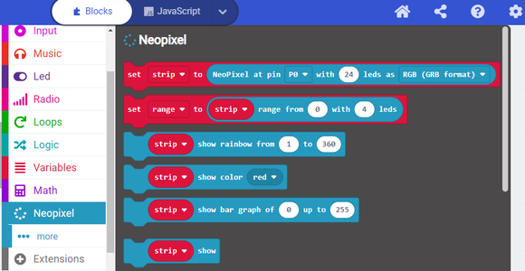

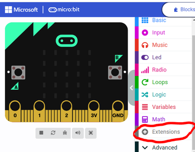

Step 2: Add Neopixel Extension to the Blocks Editor

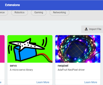

Before you can use NeoPixels with the MakeCode for micro:bit Editor, you will need to add Adafruit's NeoPixel extension to your environment. Todo do this, click on the Extension option circled.
This will open the dialog below from which you should select the Neopixel extension. Once you have done this you will find an extra category of blocks called Neopixel appears below Math where you find all blocks you need to code your LEDs.

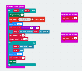

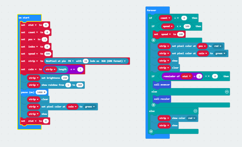

Step 3: Let's Code
The goal of the game is to stop the cycling light using buttons A+B when it reaches the indicated LED (the green one). If successful, the difficulty level will increase by accelerating the speed of the cycling light. If unsuccessful, the light cycle will restart. User can move forward by pressing button A and can move backward by pressing button B.
To code this game, I used MakeCode for micro:bit, a block-based visual programming tool. It's really easy to use, just drag and drop your blocks to write your code and you can see the result instantly on the simulator.
You can find more details about the code in this link.
