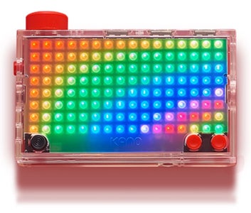

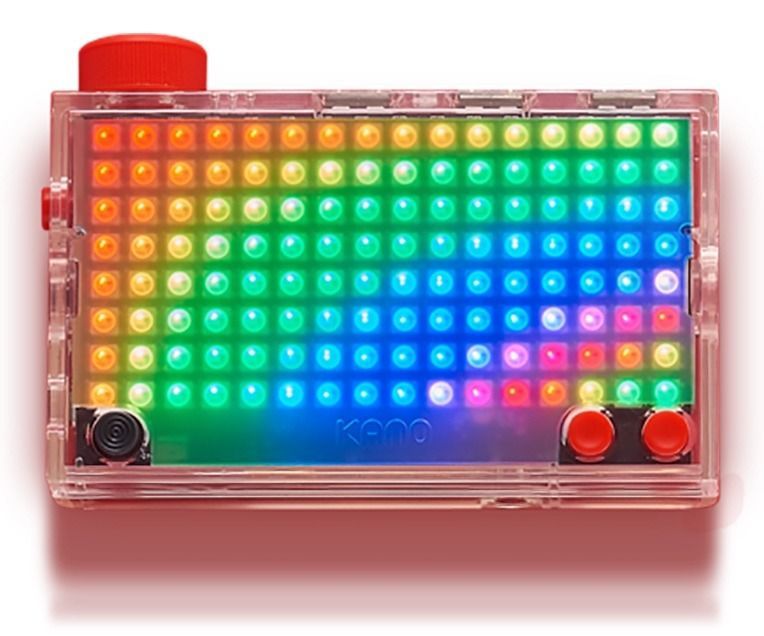

The journey to unlock the full potential of Kano's Pixel starts with replacing the factory firmware with MicroPython but that is only the beginning.
In order to code on the Pixel Kit we must connect our computers to it.
This tutorial will explain what the boot screens mean, how to access the terminal page and how to connect to Pixel Kit.
