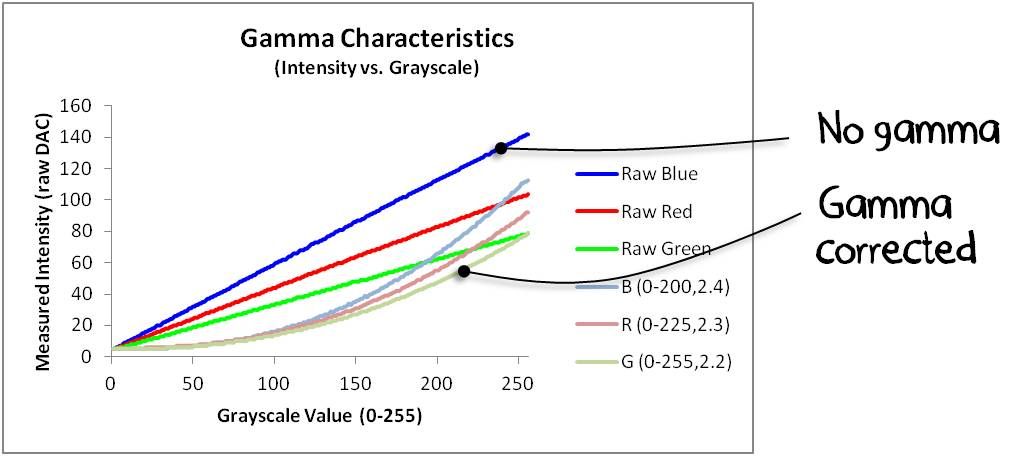

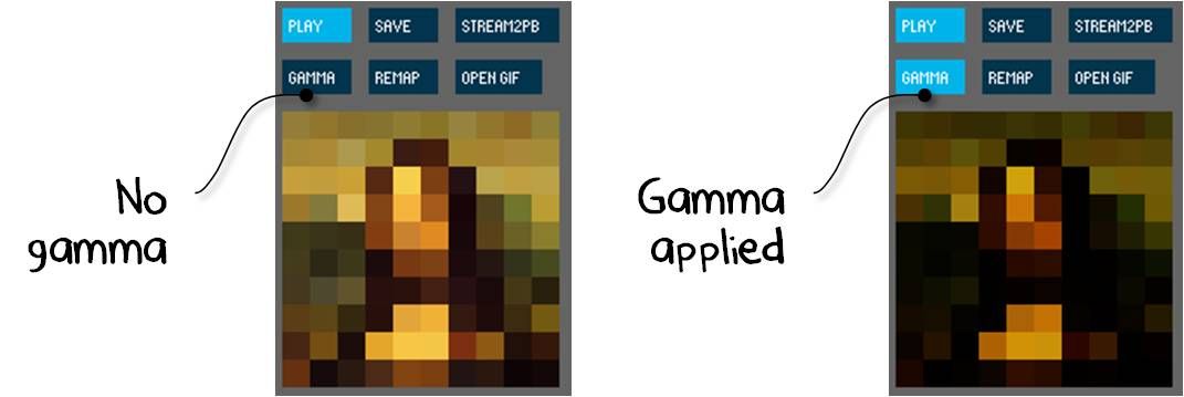

Gamma adjustment:
Easily apply gamma correction to the pixel patterns in order to generate the proper colors on the PixelBrite hardware. For more information on gamma correction be sure to check out the Measurements section.

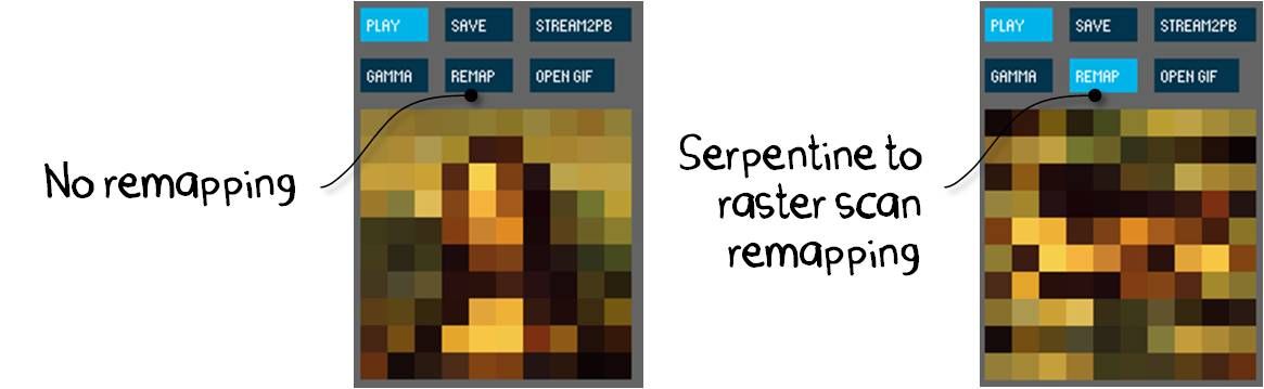

Serpentine Remapping:
As the LED wiring shows, the LEDs are connected in a serpentine fashion. This means that the order of the pixels stored in memory is different than the physical order of pixels in the PixelBrite hardware. As a result, if the image is to be displayed corrected the pixels must be saved in a new ordering. This is easily accomplished with the “Remap” button which will take a rasterscan normal pixel pattern and reorder it to match the column-major serpentine layout of the PixelBrite

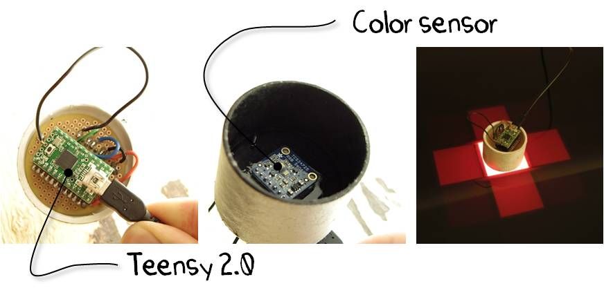

I used a Teensy, a cardboard tube, a little circular perf board from Radioshack and some black spray paint to make my own USB color sensor.
After creating a Processing sketch to measure all the pixels I was able to come up with the following image. The picture shows the 10 x 10 grid of pixels on the PixelBrite when they are displaying pure white… which doesn’t look very white does it?

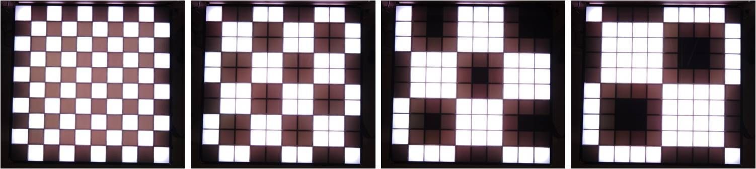

There are several reasons this looks very non-uniform.
1. They are raw measurement values, optical power not perceived brightness, they aren’t gamma corrected and so they don’t visually represent what the PixelBrite looks like (for more info on gamma correction check the following section).
2. The LEDs themselves or the driver circuits have not been calibrated or matched, and so whatever manufacturing tolerances existed appear as variations in color.
a. This would be fine for just the bare LEDs which would normally look very bright and washed out and ones that aren’t meant for displays.
Even after trying to take this data and come up with a way to improve the uniformity I relinquished because it was a bit like chasing your shadow. This uniformity isn’t constant, but rather is varies with the power, so a single look-up table (LUT) would not work. Also, the PixelBrite already looks pretty good, the non-uniformity is not really a distraction.

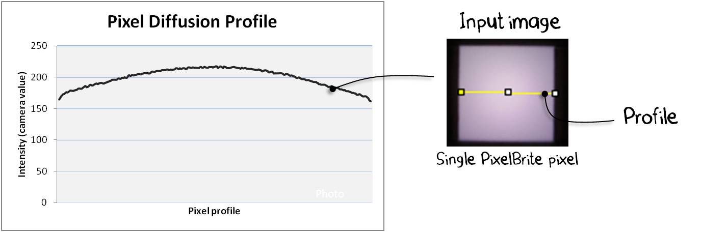

Much of the design of the PixelBrite stems from the point of removing the hotspot associated with the LED and turning it from a very bright point of light to a nice soft glowing pixel. The following figure (Figure 40) shows the intensity profile from a single pixel. While this doesn’t represent the actual optical power being put out by the pixel, I adjusted the camera settings to match my own eye, it does mirror the intensity seen by an observer. I took the photo
Achieving a perfectly flat pixel profile is very challenging. Initially I experimented with several different pixel geometries, changing both the pitch and thickness of the waffle grid until I found that with these particular brand of LEDs a waffle grid with pixels 50-60mm per side looked good enough.

The concept of gamma or “gamma correction” or “gamma encoding” is a bit tricky to explain but the basic premise is that the complexities of the human vision system require our displays be controlled in a non-linear way in order for them to look “correct.” Here’s the Wikipedia article on Gamma Correction which gives a pretty good run down.
I made two different measurements of the output of the LEDs on the PixelBrite to show what Gamma looks like.
The straight) lines show the linear output of the LEDs as the grayscale input value was increased. This is what you’d expect if you were opening a water valve, open a tiny bit and a tiny stream of water comes through, open it twice as wide and twice as much water comes through. Yet, when this mode is used the displayed image does not look correct, it looks washed out, like the following image shows.
On the other hand, the curved lines show the non-linear output when applying gamma correction. Now when the valve is opened just a fraction only a tiny fraction of water is allowed to pass through, moreover, when the valve is opened twice as wide the amount of water allowed to pass through is nowhere near double as it was previously. While this nonlinear relationship may seem odd, when gamma correction is applied the colors of the images look much more realistic or “correct.” See.
