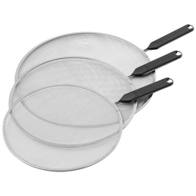

The original idea was to do this project on the window screen (you know, the mesh that keeps insects out...) as decoration, but seeing as I live in an apartment, it's unfortunately not a possible idea. Instead, I used a splatter screen's wire mesh (from a dollar store). The Pokemon theme originated from the timing of my inspiration: this idea had been sitting in my sketchbook since around February this year, around the hype of Pokemon's 20th anniversary. Now with Pokemon Go fever, I decided to review the idea.

- metal or plastic mesh (I used a splatter screen but if I hadn't found that, I was going to use window mesh or harvest some mesh from a strainer. There were also some wire mesh desk organizers that caught my eye, but the holes were much bigger and thus would have been harder to fill)

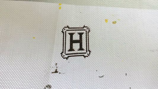

Step 7: Hogwarts Crest: Major Outlines
Inspiration from here.
I began the Hogwarts crest charmingly optimistic but ended up woefully disappointed... OK morbidity aside, it was an interesting process.

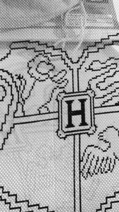

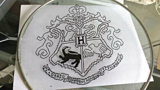

As I mentioned, dark colors go first: I started with the inside outline of the H, followed by making the border of the crest. Since it has curves that aren't very pixel-friendly, I roughly drew out a curve before quickly painting in a jagged outline of that curve (see second and third pictures above). See the fourth picture for the v pattern I used to make nice diagonals.
When working with symmetry, make the side that's closer to your dominant hand (for me, that's the right side since I'm right handed). Then to do the other side, rotate your entire piece by 180 degrees and copy the side you just finished, just upside down now.
Step 8: Hogwarts Crest: Mascots and Words
Next is to fill in the four sectors with the mascots. I freehanded each one, but you can also search up patterns online from cross stitch or perler bead enthusiasts. Again, gently sketch out a basic outline before filling that in with your actual outline. This way you have a sense of positioning each part of the animal so that all of it can fit in the quadrant.
The words were the hardest part, since I left such a small area (height and length-wise) for relatively large words. To ensure that the entire word fits without being squished or stretched toward the end to fill in a banner, I suggest starting from the middle of the word, so it'll be centered when you're done, and then working outward.
