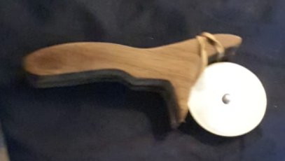

Today I will show you how to make your very own pizza cutter out of wood. The type of wood that you choose is up to you and if you don't have access to some equipment than you can always find alternatives on amazon or ebay.

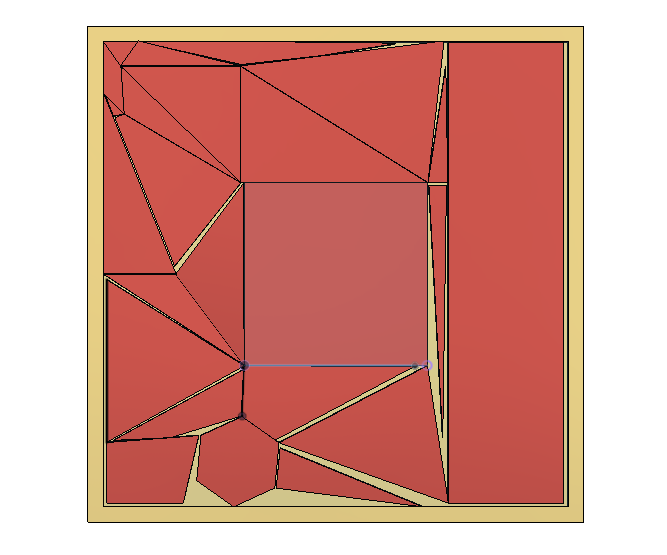

After that I decided to go on to fusion 360 if you don't have fusion 360 than you can use alternatives such as inkscape just as long as you can be able to draw your handle electronically and export it . The most important thing to remember is to measure and draw the ,metal blade accurately as you need space for the blade to sit on the wood.
Step 5: Making Using a Laser Cutter
After I drew up the handle i exported it out to the laser ensuring that the height of the acrylic was the same as the metal blade so it would be even.

After the laser cutter was finished i got 2 pieces of wood that were bigger than the acrylic and taped them down with some double sided tape. then i got the acrylic piece and taped to one side of the wood so when i trace around the acrylic the acrylic won't move leading to a better result.
Step 7: Cutting the Wood
After that I removed the acrylic and used a scroll saw to cut the wood. If you don't have a scroll saw than I recommend getting a coping saw instead as it is cheaper and works just as well.
Remember to leave the two pieces of wood taped together.
Step 8: Joining the Pieces Together
After the wood is cut then you can seperate the two pieces of wood together. Then superglue the piece of acrylic or plastic if you used a 3d printer with one of the pieces of wood then you super glue the metal blade to the same piece of wood, than super glue the other piece of wood leaving the metal blade and the acrylic in the middle.

After the glue has dried up then sand the wood using sandpaper then if you want add oil for extra protection.
