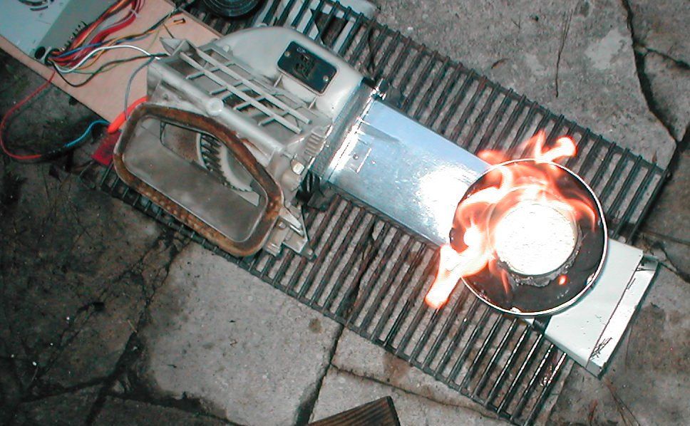

Step 8: The Burn
Make sure you have your furnace in a good place where it cant catch anything on fire, a concrete slab or sand area is best, with no trees or other vegetation too nearby (10ft or so), ashes are going to be flying in the air so make sure you arent gonna catch anything on fire.
I place mine on a barbecue grate held off the ground by jack stands, on a concrete slab.
First we need to line the furnace with charcoal. Place the crucible on top of the bottom layer so subsequent briquettes can be placed around the inside of the furnace.
Douse the briquettes well in lighter fluid, then light them....
Making a device that contains fire gives a different feeling from just about anything else. It is beautiful. :D
Let the charcoal burn for about 5-15min and get good and started, you dont want to have to relight it.
After it is going good, turn on the power. Within a minute or two all the metal around the charcoal should be glowing red.
Now start placing aluminum in the crucible, make sure to use your gloves and tongs (hold the cans/etc over the crucible and drop them in) and eye protection.
Cans are fairly low grade aluminum something better would be preferred, like broken castings or overly painted welded aluminum joints (from high class lawn furniture). Most things are gonna flame up and put on a great show when they go in the fire. This part really is fun, for all its danger.
