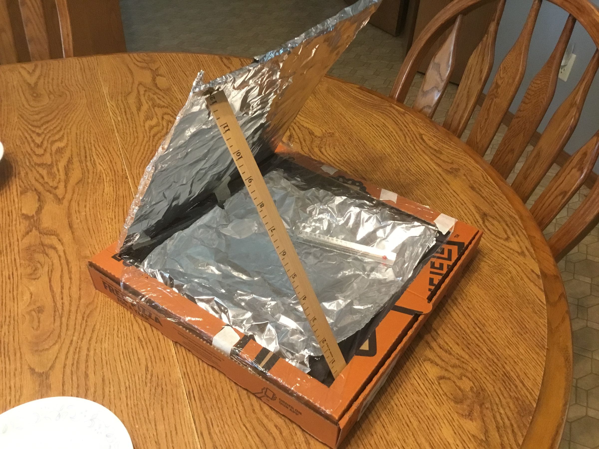

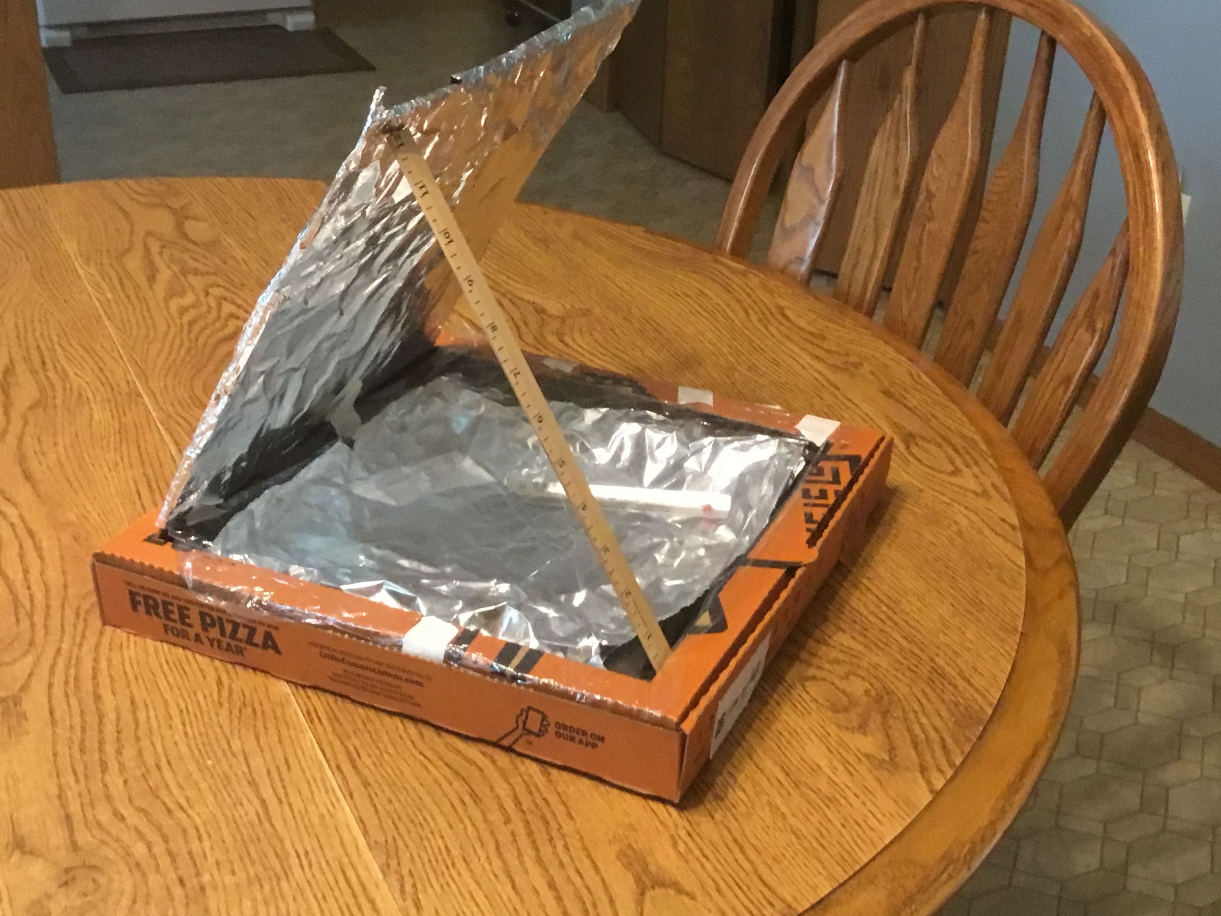

Step 1: Step 1: Obtain Pizza Box and Cut a Square (1-Inch Margins)
Use a ruler to measure 1 inch from each edge of the box. Mark the inch points and cut an appropriate size square out, leaving one side uncut to reveal a square opening. Make sure the square itself isn't too small, but isn't too big either.
Step 2: Step 2: Cover Flap With Aluminum Foil
Cut out an appropriate sized aluminum square that matches the size of the flap. Cover the flap with the aluminum square facing the inside of the box. Make sure none of the foil is covered by other objects (such as tape). Ensure that it is secure and won't fall off while in use.
Step 3: Step 3: Add Insulator
Open up the pizza box and insert BLACK construction paper throughout the base of the box. Make sure all surface areas are covered and there are no exposed sections. Add black rolls of paper to the sides of the box to ensure that heat remains insulated.
**BLACK PAPER IS NOT REQUIRED, BUT HIGHLY RECOMMENDED AS IT COLLECTS AND ABSORBS HEAT MORE EFFICIENTLY
Step 4: Step 4: Saran Wrap Opening
Take plastic wrap and cover the square opening on the box. Do NOT cover the flap with saran wrap - only the opening.
Make sure that it's tightly wrapped on and covers as much surface area as possible. Cover any openings to prevent heat from escaping.
Step 5: Step 5: Trial
Now your experimental solar oven is complete and you can take it outside for a trial run. Keep in mind, the sun is at it's strongest from 12:00PM to 3:00PM. Make sure the aluminum flap is facing the sun so as much UV rays can be collected to convert into heat energy.
Put a thermometer INSIDE the box where the food would go. Keep track of how high the temperature increases.
**KEEP IN MIND - COOKING TEMPERATURE IS AT LEAST 150 DEGREES FAHRENHEIT
Step 6: Step 7: Revise
If needed, fix any components of your solar oven to match the minimum requirements needed for cooking. Before you actually take it out and use it, look up what you're going to cook and make sure that your oven can reach that temperature.
Step 7: Step 8: COOK
Now your solar oven is complete. You've finished everything you needed to do and you can finally take it out for a spin. Bring some friends along (or even have a potluck if they have their own solar ovens) to enjoy the delicious food your solar oven will produce. Be proud that your oven is not only efficient, but environmentally friendly.
