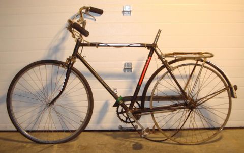

One older bike single, speed is easiest with rims that you can get fancy tires for.
I started with English made 1958 Rudge which had 26" x 1-3/8" tires. These rims require tires that go on English type three speed rims. I swapped the rims for rims that fit 26" x 1.50 tires. Also the rear rim was from a 12 speed bike that I installed a single track gear on and a year latter exchanged the rim to one that had a a coaster brake hub on it. For more fun install a 2 speed kickback coaster brake.

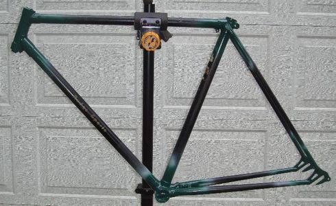

The picture shows my bare frame after I painted the parts that I won't cover with cloth. Mask off any places you don't want over spray on. Any place you bared the metal by grinding or scratches or any rusty places need to be prepped and painted also.

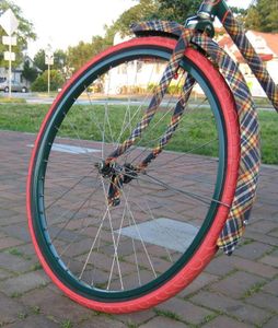

Most important, some razors, single edge they have for scraping windows or the kind you put in knifes. I used the latter being a carpenter so I had plenty. Dull ones cut badly so I went through about ten of them and there is a reason why. When I chose plaid I realized that I would get a better look if I applied it diagonally. This uses more cloth and is harder to cut strips. When you trim on a diagonal freehand it tends to have a mind of its own and you need the sharp blades to keep the seams straight.
I laid the pattern out on a large clean surface and lined up the pattern straight. I picked a diagonal and with the straight edge marked my first line and cut. I looked at my project bike and figured out where I would be putting on the plaid. Tubes are easy by measuring the circumference and then add an inch. I cut all that I needed for the project as straight as I could while not letting the pattern shift around. Other parts that are covered like fenders and chain guards needed ample amount of cloth to cover complex curves. Think ahead on those. A chain guard you will have to do some diagonal tugging but it will conform.

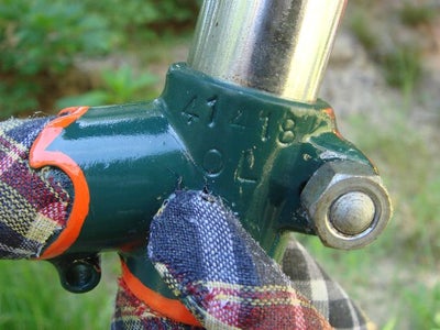

Before I started gluing, I made sure all parts are ready for the final assembly and all under parts were painted. I also painted dropouts, lugs, head tubes, and bottom brackets as they were not going to be clothed over. I made sure the strips I cut were long enough to meet my lugs or miters on the frame and then some.

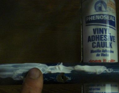

Using Phenoseal Vinyl Adhesive Translucent Caulking ( this is the glue) I applied a small bead to what will be seen the most leaving the seam for the back. How much bead depends on how much of it you can spread on to cover a half an inch. Thick or thin, too much too little. Hard to say when you don’t know. This is the part you learn by doing. Too little it won’t adhere well and too much will ooze through the cloth. It might ooze through now and then and that will be OK. The picture shows a little to much was applied.

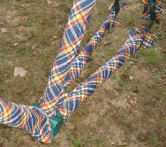

I applied the cloth centered to the tubes leaving the rest to hang down free. I was just trying to center the cloth without losing the pattern which is easy to lose when you run the cloth diagonally. Only the tops get done and has to set up so when you finish the wrap the pattern won’t shift around. Smoothing this out with my fingers I would be cleaning hands frequently. I went on to the other tubes letting this set up straight.
Once these are set then apply more glue like before to one side of the tube at a time, the first side trimmed with the razor blade by eye a little past the center point where the seam will be. choose your seam placement in areas that won't be seen like the bottoms of tubes or backsides. This is followed by the opposite side trimmed at the seam. Smooth this out with your fingers. Work out the miters and trim. Clean hands frequently. I find it’s easier to use bare hands than it is to use gloves, maybe it’s a bad idea but I like bare hands and washing them durring the gluing.

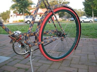

Chain guards and fenders need care because of complex surfaces. I located my starting point so that the pattern would stay straight and not shift around and then let it set. My fenders had raised and creased surfaces and you have to work those in. Then I glued up to the edges and let that set. When it comes to gluing it under, I had to cut slits to make the curves under. I trimmed it by eye one quarter of an inch beyond the edge for finish underneath where you can’t see.

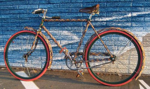

Everything was clear coated a few coats, more if you care to but you may get some shine. There may be some fuzz that the clear coat will raise up. Either like it or smooth it out as the clear coat dries. I left the fuzz proud to give the finish a real cloth feel.
Step 4: Putting All Back Together

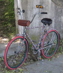

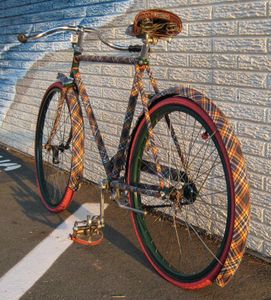

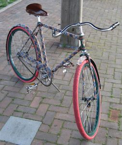

This is the best part when the roller coaster comes to a stop. I hope all your trouble was well worth it. Take a deep breath and carefully bolt it back together, take your time. You may notice that the drop bars are really bars flipped over and the wrap around fenders are really custom made from two fenders. This is a story of plaid, if you would like to know a little more I would be glad to talk about it.. A hint on the old chrome: Lemon Pledge and fine steel wool or scotch pads.
Step 5: Life of the '58 Rudge
This would have been trash but the old English bikes are built strong and last a long time. Not only that but they ride well. I wish good luck to anyone who follows these guidelines and theirs turns out well.
