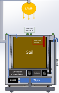

Step 2: High-level Design
Step 3: Design of Sub-systems (1)
Mechanical Systems
Requirements

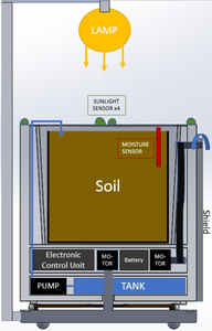

In general the mechanical design has to guarantee, that the plant and the tank as well as all sensors, actuators and electronics are safely stored and are able to operate correctly. At the same time the cost and the size of the design has to stay as low as possible, to ensure a certain commercial value. That means the housing has to be rigid, such that the torque can be transmitted on the rotational parts. But as the robot will be operating indoors and is not exposed to external forces and influences, the requirements for the material are low.

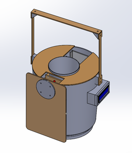

Conceptual design: preliminary concepts and selection
Four variants were designed as shown at the beginning of the step:
- Upper lamp is directly attached on the pot of the plant; only the pot is rotating with the turning plate, the cables are going through the plate designed with circle-shape circuits in it. Thus the major electronics are in the base and are not rotating.
- Upper lamp is directly attached on the pot of the plant; all the electronics components are rotating.
- The upper Lamp is connected to the base; only the pot is rotating with the turning plate, the cables are going through the plate designed with circle-shape circuits in it. Thus the major electronics are in the base and are not rotating.
- The upper Lamp is connected to the base; all the electronics components are rotating except the lamp so
A selection process between the variants took place. The chosen variant is the base for building the prototype. The concept where everything is rotated together (cf. first figure of the four shown above) as shown with the above comparative table at the beginning of the step, with criterias of different importance coefficients (from 1 to 3) that multiply the score of the row (which can be 1 to 4 as described in the right table).
Here is a complete description of all the parts of the concept:
Rotation mechanism
For the rotation a turning plate with built-in ball-bearings is used. Due to the low friction of the part, there’s no need for a gearing system, as the torque of the stepper motor is high enough and the small step size of the used model is also sufficient.
Sunshielding
After several changes and considerations, the sunshield is attached to the top of one side of the robot and is realized as a stiff rectangle, which is able to rotate up and down. Due to a lack of space at the top of the robot and the issue of weight distribution, the stepper motor to rotate the shield is stored at the bottom of the robot. The shaft of the sunshield is reached via a belt. With the separate construction to fix and tension the belt with an additional, movable screw, the torque is transmitted from the motor to the sunshield.
Watering
The watering of the plant is realized with a refillable tank and a pump. With this solution, the tank and the pump can be stored at the bottom of the robot, where there’s enough space and the weight is nicely distributed. Concretely, the tank is small plastic bottle with a hole in the cap, which can be unscrewed to refill the tank.
Artificial light
The additional light source is a LED, which sits on top of the plant. It’s fixed to a support structure in the shape of a flipped U.
Housing
The housing is divided into an upper and a lower part. The upper part all the electronic parts and ressources for the plant, the lower part is connected to the environment of the robot to enable the application of the torque for the rotation. The two parts are connected via the turning plate and the shaft of the stepper motor that rotates the robot.
A big plastic plant pot serves as the upper part. It is horizontally divided into three sections. The bottom section contains the two stepper motors, the tank and the pump. The sunshield installation with the belt is also fixed to bottom part, but goes throw all three sections. The second section delivers storage for the Arduino, the battery and the two stepper drivers of the motors. The plant itself is located in the top section as well as all the sensors. Wooden plates serve as deviders and bottom plates for the corresponding section. The bottom plate is screwed to the big housing plant pot and has some holes to fix the motors. The middle places is cut out in the shape of the tank, to stabilize it. It also contains cut-outs for the cables and the water pipe. The same goes for the top plate. The two upper plates are fixed to housing pot at four positions with 3d printed connectors.
The bottom part of the housing is a 3d printed circular plate. It contains a connecter-hole for the shaft of the stepper motor and 4 holes at the bottom, to screw it on any desired ground plate.

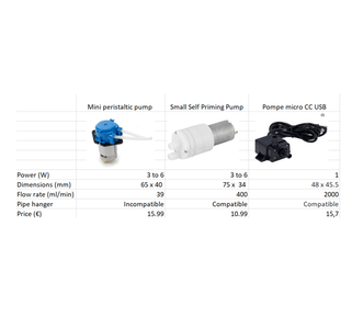

The pump :
The chosen pump is the Small Self Priming Pump (cf. Figure 1). Indeed, this one is compatible with the tubes that will be used, has a correct flow rate. In addition, it is the cheapest. However, the dimensions of the latter are slightly larger, but its other advantages led us to choose it. For the debit a calculation was done for this pump at 5V. The time taken by the pump to fill a 50ml container with water has been placed in Figure 2. To calculate the debit, the quantity of water (50ml) was divided by the time taken. The average debit is obtained by summing all the debits and by dividing it by the total number of tests. The value obtained is 6.727 ml/s. The flow rate is sufficient because a higher flow rate could cause splashing which could eventually damage the electronics below.

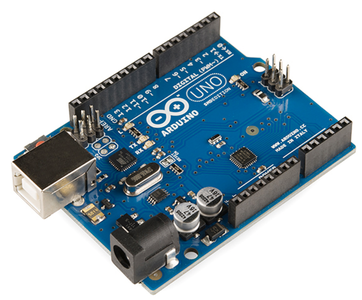

An Arduino UNO was chosen instead of a Raspberry Pi for several reasons. First, the Arduino's hardware and software are open-source: a lot of codes are already available and easy to adapt to a specific task. Then, it's easy to program through Arduino IDE and finally, it has a huge community which is very helpful for a beginner if he has questions (cf. Figure 5).

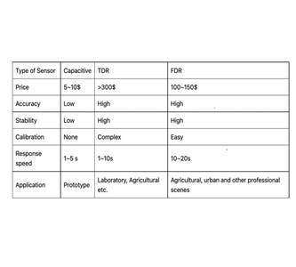

The soil moisture :
The last picture shows the different criteria used when choosing the soil moisture sensor. A capacitve soil moisture sensor was chosen due to its simplicity and its price (cf. Figure 7).

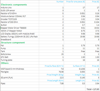

Step 8: Bill of Material and Cost Analysis
As you can see on the first picture, it contains the price of all the components of the robot. The prices shown below are only valid for one or two components, but in case of larger quantities purchased, the price will be lower.This can be seen for example with the arduinos on the second picture. Also it is important to consider the cost of labour, the cost of production (laser cutter, 3D printing,...).
