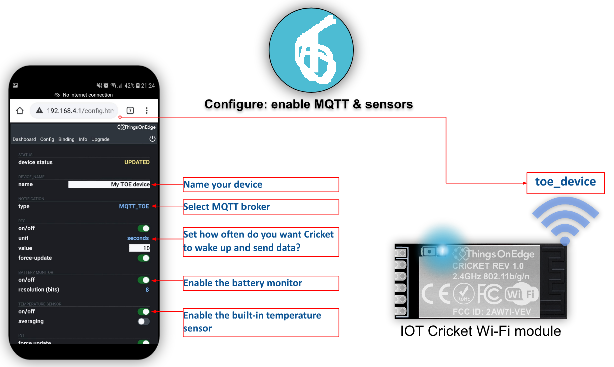

    IOT Cricket is an easy-to-use ultra-low-power WiFi module, which can operate directly on batteries for a very long time (for years in many use cases). We can simply attach a sensor & battery and the device is ready to transmit data instantaneously via WiFi networks. But before starting the data transmission you need to configure it for connecting to your local wifi network. Don't be afraid, configuring Cricket is easy!
    Along with setting the wifi name and password, we will also configure the IoT Cricket module to read moisture sensor data and send the data to the cloud. We will use MQTT for sending data to the cloud and Cricket has its own MQTT server. Confuse with MQTT? Read all about MQTT protocol from the following link: https://www.hivemq.com/mqtt-protocol/

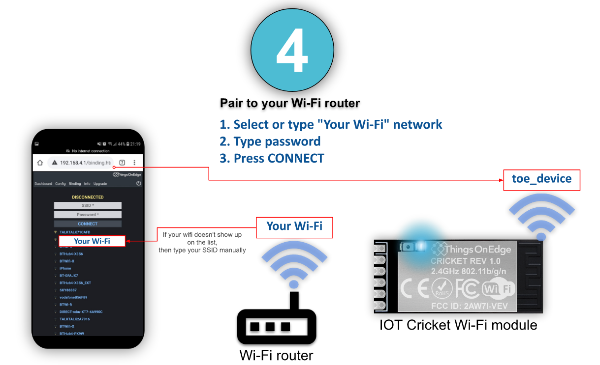

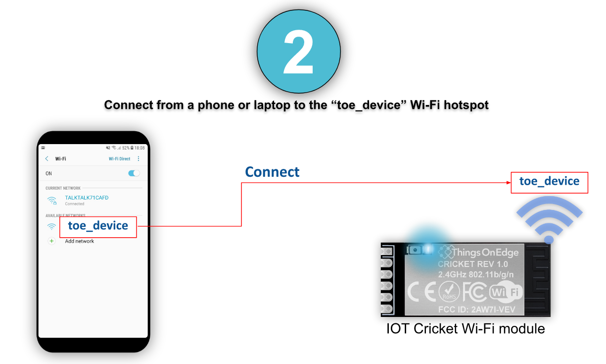

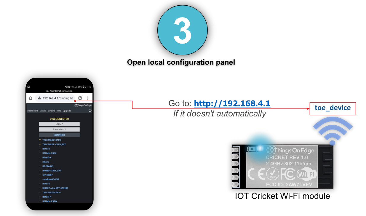

    Without wasting further time let start the configuration. First, we need to connect the Cricket to our WiFi network. To do this
    1. Press the built-in Cricket's button for 5 seconds (it will start a new WiFi hotspot named as toe_device)
    2. Connect to that hotspot from a phone or laptop
    3. Set your WiFi credentials: SSID and Password and press CONNECT button.

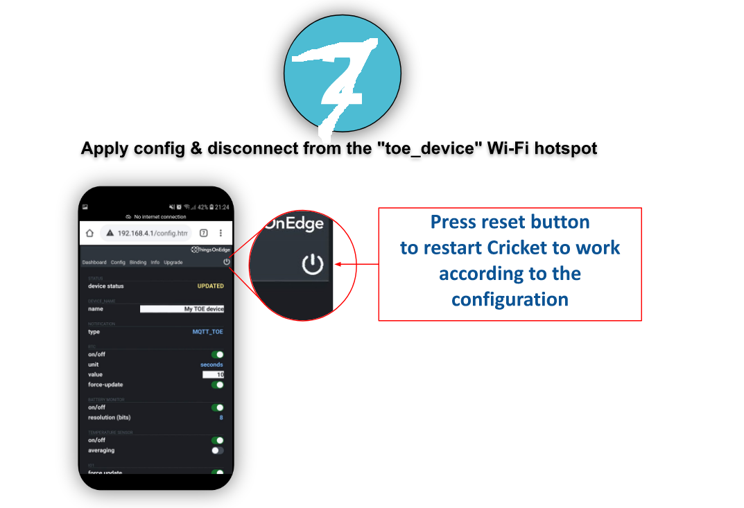

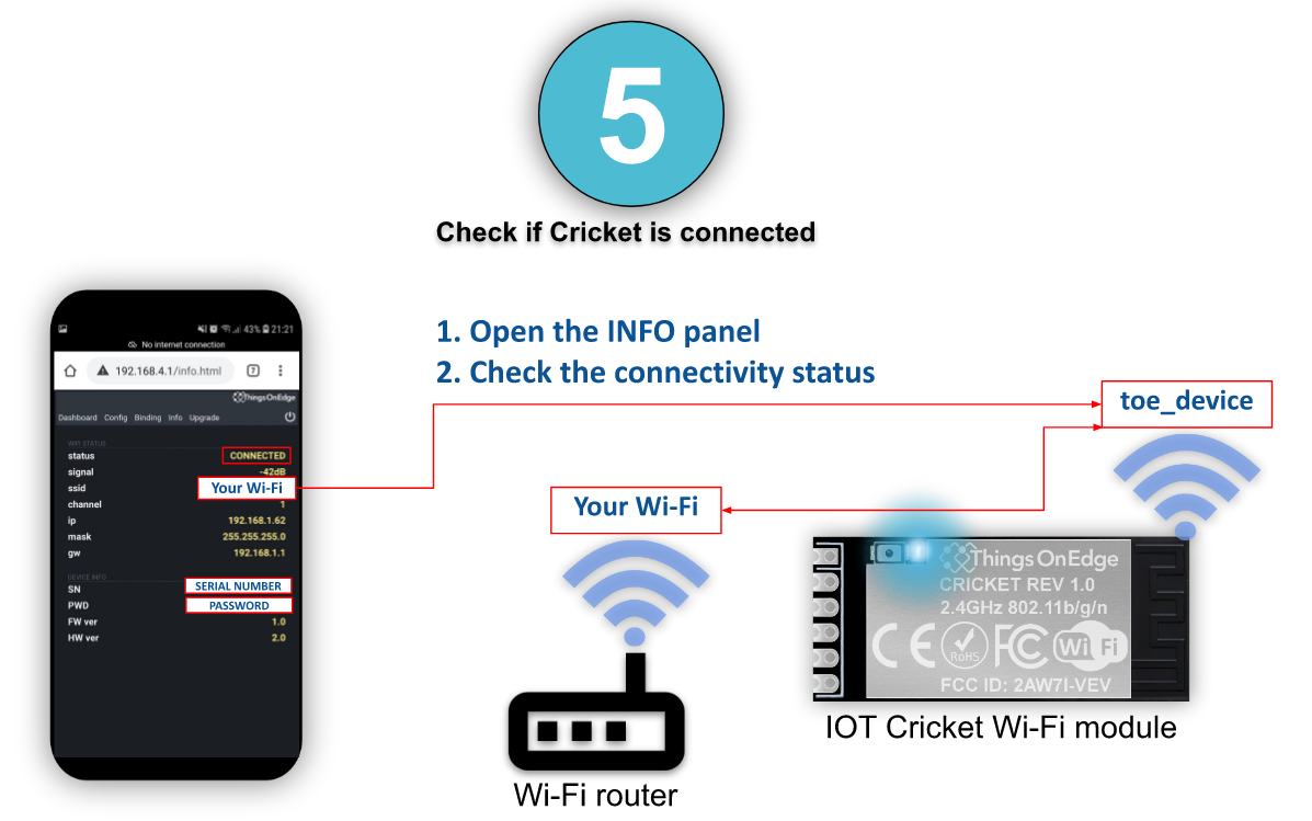

    Follow the images below to configure your device step by step. From step 5 you will get the unique device serial number. Note down the serial number, it will be required for connecting with the mobile app. See the image attached at the beginning.

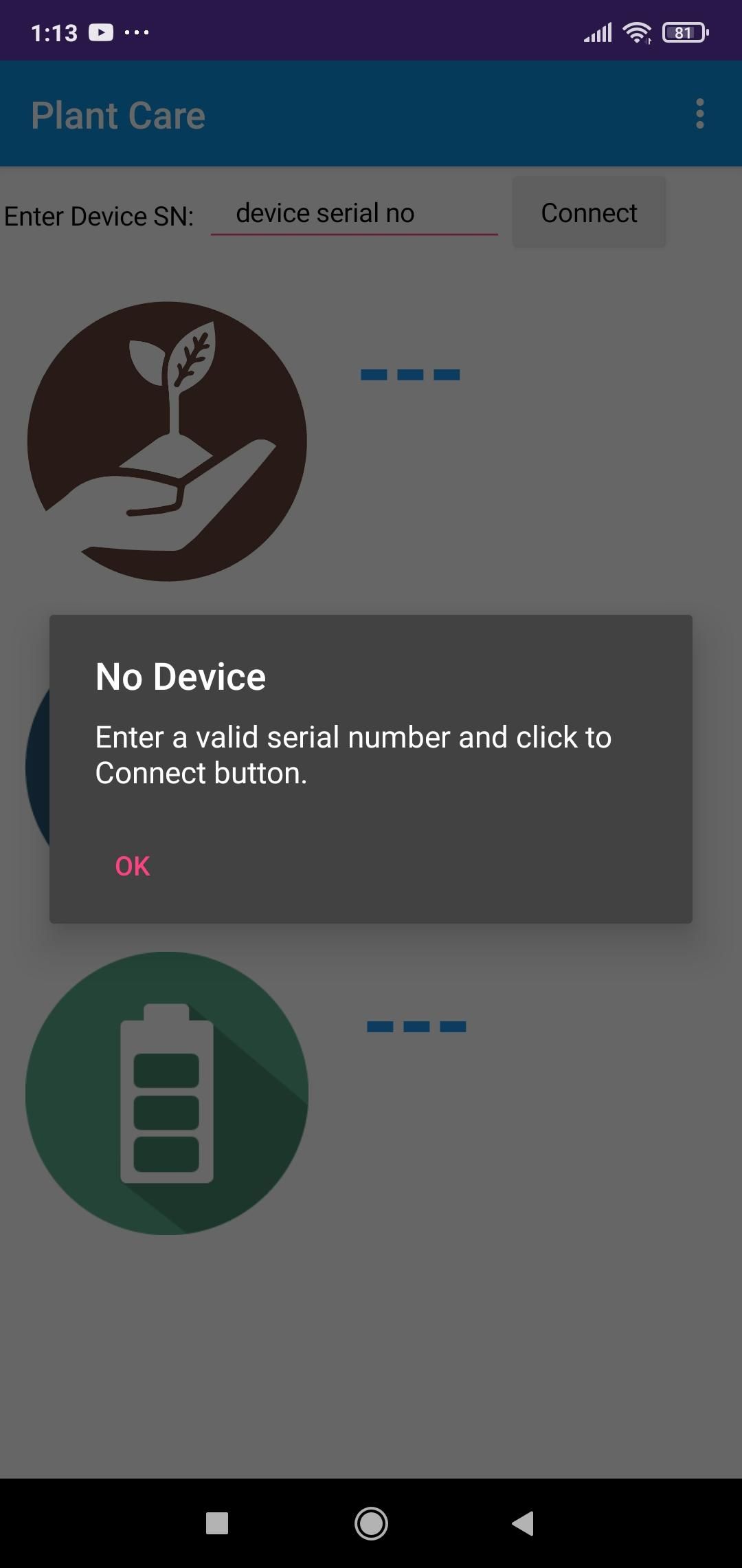

    After installing run the application...
    Device configuration

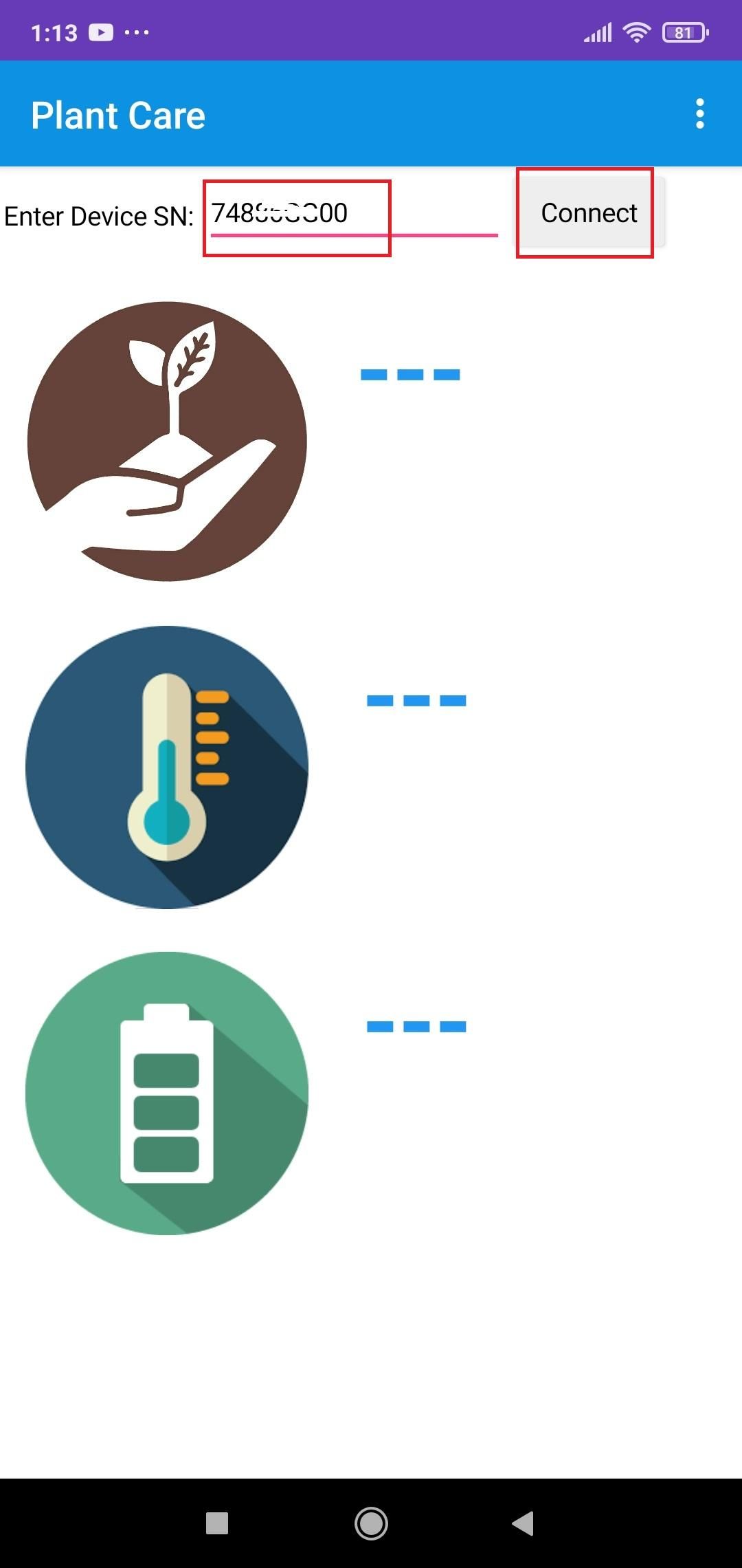

    After running you need to provide the serial number of your Cricket module. You can get it from the configuration panel of the cricket and probably you noted it while configuring the Cricket, now you have to use it. After entering the serial number just click the Connect button.

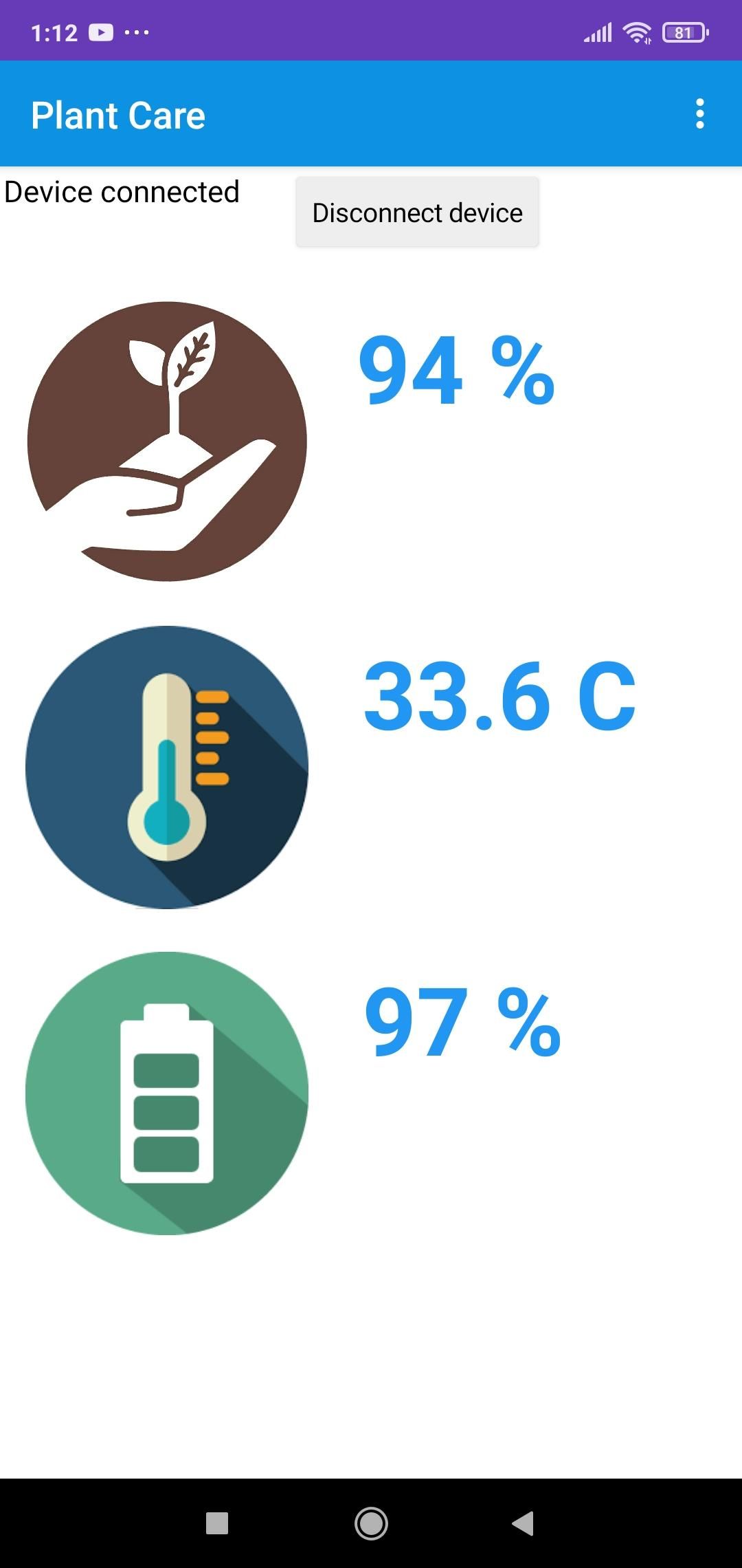

    If the configuration of the Cricket goes well and the device is powered up then the device will be connected to the app and you will receive the data as like the following image. If you get it then Congratulation! You did the hard part and your device is almost ready.
