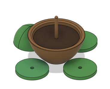

Plant Coasters are 3 round cactus coasters placed in a decorative pot. Coasters are frequently arranged in unappealing ways in homes, making them appear ugly and out of place. Plant coasters are made to be both a decorative and practical addition to a comfortable eating or living area. They are designed to fit the environment of a cozy dining room/living room as a decor piece as well as a functional piece.

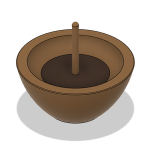

Step 1: Pot (Body)
Set Units to INCHES
Create a pot body where you will put the coasters in.
  1. Create a sketch on the right plane and sketch the side view of a half of a pot
  2. symmetrically mirror the sketch, then revolve around the axis
  3. Create a sketch on top plane
  4. Draw a circle for the stick in the middle
  5. Extrude the circle upwards for the coasters, fillet to make a round edge

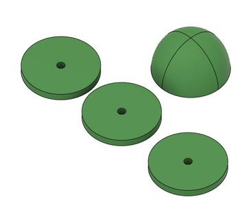

Step 2: Coasters
Create 3 coasters
  1. On the top plane, create a sketch and draw one circle
  2. ^^ this circle can be any size, as long as it's smaller than the pot
  3. Draw a smaller circle inside (the same size as the stick)
  4. Extrude these circles upwards, leaving the inside circle empty like a hole
  5. Duplicate this coaster 2 times in order to make 3 coasters

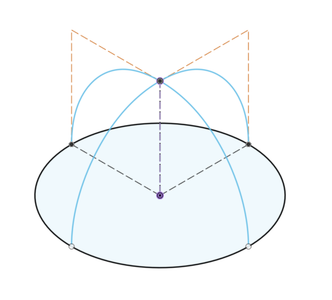

  1. Create a circle on the top plane and finish sketch
  2. ^^ this circle should be the same size as the other coasters

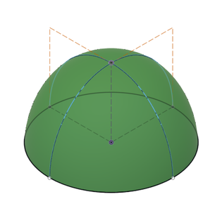

  3. On the right plane, create a fit point spline arch on one side that is tangent to the sides of a rectangle, then mirror
  4. Do the same thing with with the left plane
  5. Create a loft, and use the fit point splines as rails to create a round cactus tip shape

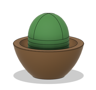

Step 4: Assemble
Assemble the piece
You're done now!
