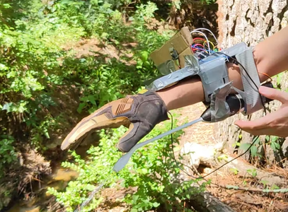

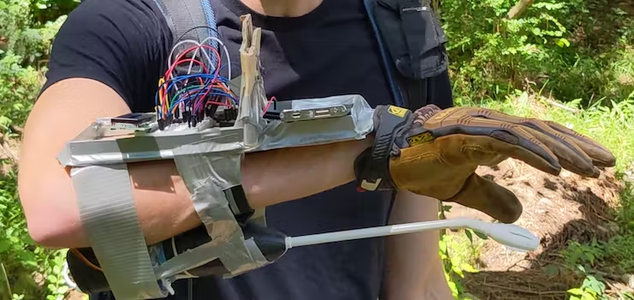

Step 6: The Crazy Contraption
While I can't see this ending up in any Walmart's anytime soon, it turned out in a pretty fun way.
To get the poison ivy spraying aspect to work, I had to use a weak servo because the powerful one I bought apparently wants to spin indefinitely, which really defeats the purpose. So, I held the spray button down such that it just barely wasn't spraying, so that all that the servo needed to do was provide just a tiny amount of additional pressure. This worked about as perfectly as I could have ever hoped something engineered together with duct tape and rubber bands could work.
For power, I found an old on-the-go phone charger from the dawn of time. Amazingly, it still worked.
I found some random metal piece in the garage and attached a cardboard base to it for a place for all the electronics to sit. To attach that to my arm without the involvement of duct tape and a horrifying sacrifice of arm hair, I found one of those old ipod holders that attaches to your arm so you can listen to music while you run. This worked great.

There were admittedly multiple occasions that the contraption identified my lawn as an airplane, which I'm fairly confident is untrue but who am I to make that kind of ruling? Regardless, for 28x28 resolution I was very pleasantly surprised at how well this worked. It was reliably confused about whether morel mushrooms were dogs and vice versa, but the thing is it consistently thought it was one of the two (with a couple exceptions). The area in which it performed best was, thankfully, in identifying poison ivy! This was where it very consistently would see poison ivy leaves and activate and, by the power of God and anime, the servo actually successfully had just the right amount of force to turn the spray on when it saw it and then back off.
So there you have it, the crazy glove that is surprisingly good at finding and killing poison ivy. It's also convinced half the time that dogs are oyster mushrooms and vice versa. Either way, it was a good time and an entertaining way to get started with the Spresense hardware, the Neural Network, and to learn more about the world of Arduino. Hope you enjoyed the ride!
