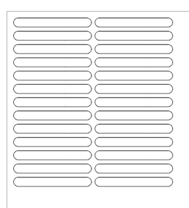

Step 2: Cut Positioning Template
To position the craft sticks accurately for etching the labels, I created a positioning template out of corrugated cardboard. For best results, leave the template in position after cutting it out and place the painted sticks carefully in the slots without moving the template.

Step 4: Laser Etch Plant Names and Cut Out the Tips
Place the painted craft sticks in the slots cut in the cardboard to easily line them up for cutting and etching - note the painted end of the stick is to the left.
Send the print file to the cutter to cut the tips and etch the plant names.
