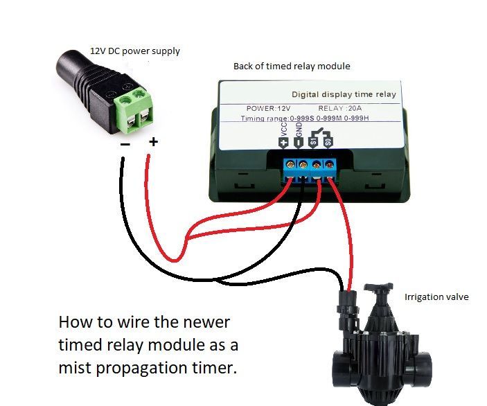

Step 2: Hooking It Up...
The wiring is quite simple but it is important that you attach the wires correctly or damage to the equipment can occur.
Note: On each end of the timer relay there are 3 terminal blocks. On the input side, the unused terminal is for a trigger signal which we will not be using in this application as we want the timer to cycle continuously. On the relay side the extra terminal is the "normally closed" pin off the relay and would cause our timing to be the opposite of what we desire (a short run time followed by a long pause). Both these terminals should be left empty.
Begin by determining which is the positive and negative output of the terminal block. They should be marked with a plus sign and a minus sign.
1) WHILE UNPLUGGED FROM THE WALL attach a piece of wire from the "+" terminal on the power supply to the VCC terminal on the timer relay board. This is marked on the back of the board but it is the top terminal closest to the number display.
2) Attach a second small piece of wire from that same terminal on the timer/relay around to the center terminal (labeled "COM" on the back of the circuit board) on the relay side.
3) Connect a wire from the bottom terminal (labeled "CK" on the back of the circuit board) to one of the wires of your irrigation valve. (either wire should work).
4) Connect the other wire coming off the solenoid valve to a wire which connects to the bottom terminal on the timer side of the timer/relay board (Labeled GND on the back of the circuit board).
5) Finally, complete the circuit by attaching a second wire to the GND terminal on the timer side of the relay and connect it to the "-" terminal on the power supply.
6) Make sure all connections are secure and there are no lose or exposed wires which could cause a short.
7) Plug in the power supply and the timer module should light up. If it didn't, unplug and check your wiring. If it lit up- time to program the timer.
