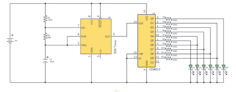

Step 1: Create the Rider Circuit
This circuit will be used as an indicator of when the plant is under-watered. Wire this circuit from the schematic on the breadboard. Make sure the wire that powers the Rider Circuit is connected to one of the pins of the circuit. NOTE: Power to R1 or the first resistor that is a 1k Ohm resistor and will need to be changed to have it connected to one of the Arduino Pins. R3 or the third resistor does not have a 1k Ohm resistor for this project, but instead has a 330 Ohm resistor.
