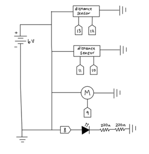

This project is an automated plant-watering device, called the SAP (Save All Plants). It features two inputs in the form of two ultrasonic distance sensors. It has two outputs - a 9g micro servo motor and a red LED. There is a watering pot that is suspended upright in the air by two columns made from 5x7 in slabs of cardboard, and fastened by machine screws and hex nuts. One sensor is attached to the end of the watering pot. It detects the distance the spout of the pot is from the plant. The second sensor sits on the opening of the watering pot, looking into the pot. It measures the water level. The motor sits below the pot. As it rotates counterclockwise, it pulls a string. The string is attached to the spout of the watering pot. It lowers the spout, allowing water to flow out of the pot into the plant. The sensor attached to the spout detects that the distance between the spout and the plant is decreasing, and once the distance reaches less than 5 cm, the motor begins to turn clockwise until it returns to its initial position. The pot is once again upright. The sensor that sits in the watering pot will signal the red LED to turn on when it senses that the water level is more than 5 cm away. This distance of 5 cm between the water level sensor and the water level equates to the amount of water that the watering pot needs in order for the system to work. Lastly, there are weights attached to the back of the watering pot, that counteract the change in center of gravity that the rotation of the pot and the movement of the water within it cause to the structure. These weights allow the pot to return to its upright position when the string is loosened.

1. Assemble circuit, referring to the circuit diagram.

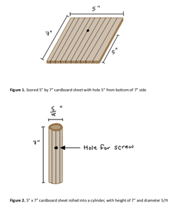

2. Score two 5x7 in cardboard sheets by using scissors to indent (but not cut all the way through) cardboard along its longer side. Use the tip of the scissors to create hole in each sheet 5” from the bottom of the 7” side. See Figure 1 for drawing.

8. Roll each cardboard sheet into a cylinder using the scores made in Step 2. The cylinders will have 5” circumferences. See Figure 2 for drawing. Use tape to join the two ends of the cylinder together. Tape the base of each cylinder to whatever surface you want the device to rest on. I used a desk.
