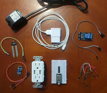

I have kept the parts list to a minimum compared to the Garduino Instructable since component boards are now readily available.
Microcontroller Components:
Electrical Components:
  • GFCI electrical socket
  • Plastic gang box
Watering Components:

The wiring of the components is very simple especially when using one-wire components. Start off by connecting the breadboard rails to the power source. While the Spark runs on 3.3V the VIN pin is directly connected to the 5V power source. Connect the VIN to the + and GND to the - on the breadboard.
Let's start off with the soil moisture probe. Connect the two wires from the probe to the sensor. The order of the two wires is not important. Then connect the VCC and GND to the + and - rails on the breadboard. Finally connect the AO pin on the probe to the A0 pin on the Spark. We'll take advantage of the analog values from the probe in the application.

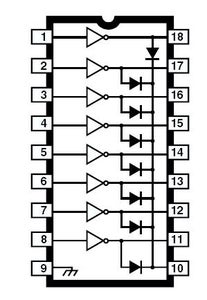

Next is the relay. I added a ULN2803 to invert the signals from the Spark to the relay board. This makes it so that when the D2 pin is set HIGH that the relay flips and supplies power to the water pump. Without inverting the signal would mean that the default state of LOW would trigger the relay to start the water pump. This could cause quite a mess of overflowing water should the power become interrupted to the Spark.
Connect pins 9 and 10 of the ULN2803 to the - and + on the breadboard rails. Pin 9 is GND and Pin 10 is VCC. Next connect D2 of the Spark to Pin 1 on the ULN2803. Finally connect VCC and GND of the relay board to + and - on the breadboard and IN on the relay board to pin 18 on the ULN2803.

The other takeaway is that I added a ULN2803 to invert the required signal to the relay to use a HIGH signal from the Spark Core rather than a LOW. The relay boards trigger when the its input pin is LOW and that is the default for all pins on the Spark Core when starting up the Core. As my plants are in an office I must ensure that a power interruption does not cause the pumps to provide water until my Spark Core program can turn them off. The solution was the ULN2803 and to keep the pins LOW from the Core and let the ULN2803 invert them to HIGH to the relay board.
