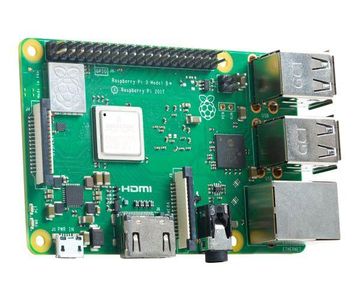

Step 5: Step 5: Preparing the Technology - Raspberry Pi
Flash a micro SD card with an operating system
Insert the SD card into your Raspberry Pi

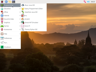

Boot up the Pi, connect it to wifi, and download these software: Processing, Arduino IDE and OpenData
Libraries: [to be added]
Put the code onto the raspberry pi either through a git request in the terminal or by USB.
