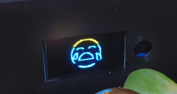

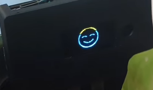

How to read plant Health using EMOJIS?
There are 3 EMOJIS to indicate the health: refer images above (basically how much it has been watered):
  1. Happy: The plant is watered well
  2. Neutral: The plant may need some water
  3. Sad: The plant needs to be watered

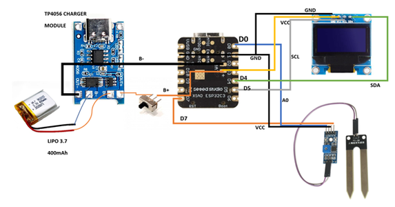

I am using a Soil Moisture sensor (refer to image). This sensor measures moisture content of the soil based on resistivity.
When the two probes of sensor are inserted in the soil, based on how much moisture is present in the soil, the sensor produces analog readings.
Example if u power the sensor in the air it gives the maximum analog output i.e. 4095 (in case of esp32 ). When inserted in the soil, it lowers to value less than 2000, if the soil has been watered recently.

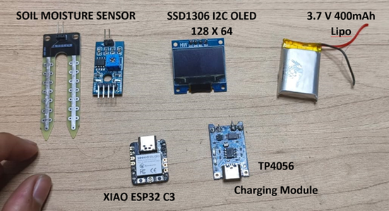

You will need Electronic and 3D printed Parts:
Electronic:
  1. Soil Moisture sensor
  2. SSD1306 128 X 64 I2C OLED
  3. XAIO ESP32 C3
  4. TP4056 Charger Module
  5. Lipo battery 3.7 V 400mAh(400mAh or more is fine)
  6. Slide switch

Solder each of these parts to the XIAO ESP32 as shown in Circuit Diagram

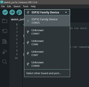

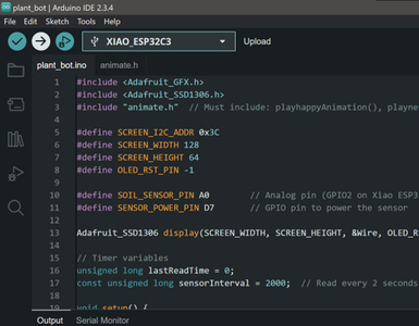

Step 2: Connect ESP32 XIAO C3 Using the USB C PORT
If you dont have ARDUINO IDE yet, you can download it on their website.
once downloaded, connect your XIAO ESP32 C3 to your PC using a type c cable.
You will find the connected device as a "ESP32 Family Device" as shown in Image.

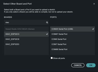

Then click on it and you will get a dropdown, press "select other board and port"
Search for XIAO and you will get a C3 option in the list select it.
Code on Github:
Planto: Github
Optionally I have attached the files.
Download the code files attached, you will have two files, one animate.h and other as plantbot.ino
NOTE: Download both the files and store then in a single folder.
NOTE: In the code you will find Threshold values for Sad, Happy and nuetral functions. You can change the value based on the readings you get, in my case anything below 1800 meant the plant was watered well.
After extracting, In the folder simply press on plantbot file.
You will need the following libraries to be installed:
  1. Adafruit SSD1306
You can go to library manager, search for "SSD1306" and you will find it. Install it.

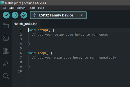

Step 3: Flash the Code to ESP32
Press upload as shown, it will compile and then upload the code to your ESP32 XIAO Board.
As shown in second image it will be uplaoded.
Now press Ctrl+shift+M to open serial Monitor.
See the values being printed.
They will be 4095 as it hasnt been put in the soil.

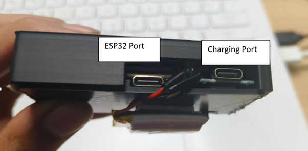

Now for the final assembly
Step 4: Assembly With 3D Printed Parts
Do check the video on how the parts have been assembled
Step 5: And Thats It!, You Have a Planto Device
Do watch the video to see how the device Works!
Additional Note: You can set the sensitivity of the device using the hole on the front where u can use a screwdriver to set how sensitive it should be.
