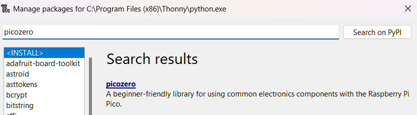

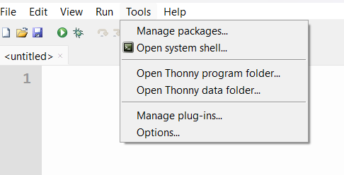

Now lets install the PicoZero package. Go to tools, and then Manage packages...
  • Lets install the PicoZero, plug in.
Search for 'picozero' in the search bar. Click on it and hit install.
That's it! We are now ready to program on the Pico...yay!

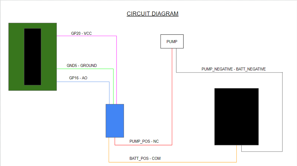

Now lets actually make the circuit.
I have created a bare bones circuit diagram here.
I have tried to colour coordinate everything to each component. Lets start by attaching the Pico to the breakout board and wiring the relay to the board.
Firstly, place the VCC onto GP20 it should say 3V3 on the board and is above VREF which is also marked on this board, shove the wire in and screw it in.
The second, ground wire, goes to the lowest GND port on the right side.
Lastly is the AO of the relay going to GP16. Secure those wires in
Next up, the battery pack, attach the positive wire of the battery pack into the COM part of the relay and screw that in place.
The battery pack's negative wire will go fit onto the pump's negative wire.
Finally, plug the pump's positive wire into the NC. Completing our circuit.
You can place the GND and VCC of the breakout board anywhere really, just keep in mind that the AO will have to be changed in the script to whatever number pin you plugged it into.

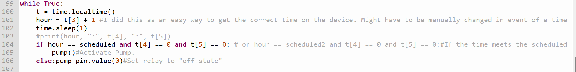

Step 3: 'Programming'
Technically, YOU are not programming at all. You are more, copy pasting a script in. No worries, I will explain how the code works anyway.
To create this script I had the help of some lovely people on the Raspberry Pi forums.
It can be downloaded here.
THIS MUST BE CONFIGURED FIRST, which is why we have Thonny or an equivalent.
You will need to put in your WIFI credentials into the 'ssid' and 'password'.
Additionally you can set up the scheduled times, duations and what specific hour, minute, or second you want the pump activating.
If you put the pump elsewhere on the breakout board, the value can be changed in the pump_pin setting.
One other thing is at the bottom of the script, where I add an extra hour onto the time being received, I wasnt sure how to make it use the BST instead of the GMT but that was my fix, You can add or deduct time from the value in this line here. (on line 101 specifically).
Apart from that, you can also add extra scheduled times if you want to in this area.
Just uncomment it here or even add another scheduled time if you feel like it, just make sure you specify the hours and minutes to be at 0 otherwise it will keep turning on and off for an hour, drowning your plant. Not good!
Other than that...
Lets explain how it works a little bit.
  • Firstly is connects itself to the internet. It will attempt to connect to whatever SSID and Password has been provided in the script.
  • From the information given, it will constantly update itself with the time value we are asking the device to get. I am using the hour value to add an hour onto it to get a more accurate time for BST, as I couldnt figure it out. (Please do tell me how if you know!)
  • Once the hour, reaches the scheduled value and is at minute zero and second zero specifically, the pump function will activate, turning on the pump for the allotted time we provided. (in my case, 5 seconds) and then will switch off until the time reaches the scheduled time again.
  • And thats it! It repeats this indefinately. Until we unplug the circuit anyway.
