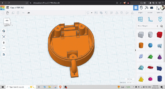

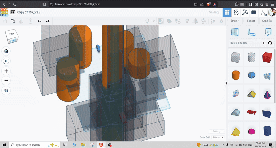

Step 1: Designing the Custom Back Cover in Tinkercad
I designed a 3D-printed back cover for this project that fits perfectly with the CNC metal case. The design was created in Tinkercad, an easy-to-use online 3D design tool.
The back cover is made in such a way that the battery can snap-fit inside without the need for screws or glue. In the same way, I created a slot for the mini slide switch, so it can easily slide into place and stay secure, again with no extra mounting required. Finally, the back cover attaches to the CNC case using the original screws that come with the case, making the whole assembly neat and reliable.

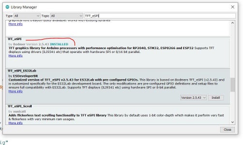

Step 4: Setting Up the TFT_eSPI Library
To run the graphics on the round LCD screen, we need the TFT_eSPI library. This library is designed to drive many different displays, so we must configure it properly to work with the Waveshare ESP32-S3 Round Display (No Touch). Follow the steps below to install and set it up.
1. Installing the Library
  1. Open Arduino IDE.
  2. Go to Sketch > Include Library > Manage Libraries.
  3. In the Library Manager, search for TFT_eSPI.
  4. Install TFT_eSPI by Bodmer (version v2.5.43 is recommended).

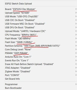

  1. Make sure your ESP32 Board Package in Arduino IDE is installed and updated to version 3.3.0.
  2. Download the Planum code from my GitHub and open the project in Arduino IDE.
  3. Go to the Tools menu and set the following options:
  4. Board: ESP32S3 Dev Module
  5. CPU Frequency: 80 MHz
  6. Flash Size: 16 MB
  7. Partition Scheme: Custom
  8. PSRAM: QSPI PSRAM
  9. Erase All Flash Before Sketch Upload: Enable
  10. Connect the device to your computer using a Type-C USB cable.
  11. Select the correct COM port for the device in Arduino IDE.
  12. Click the Upload button to program the ESP32-S3.
  13. If everything is set up correctly, the code will compile and upload successfully. After a few seconds, check the round display: a red or green bubble should appear, confirming that your configuration and code are working properly.

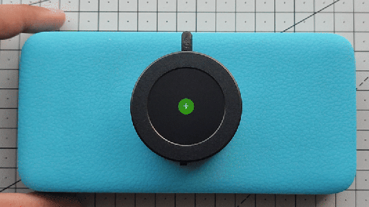

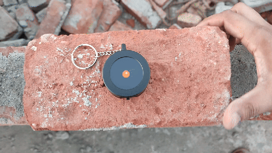

Step 10: Using the Device

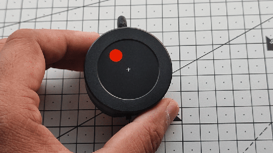

After completing all the previous steps, your Planum device is ready to use. Here’s how it works and how to control it:
  1. Power On/Off: Use the mini SPDT slide switch to turn the device on or off.
  2. Using the Device: Place the device on the surface you want to check. The display will show whether the surface is flat (green bubble) or tilted (red bubble).
  3. Calibration: If the device is not giving accurate readings, follow the next step to calibrate it.
  4. Charging: The device can be recharged using the Type-C connector at the bottom. Simply plug in a USB charger to recharge the battery.

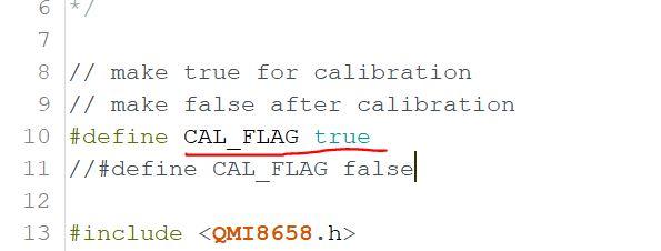

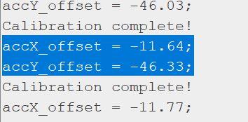

Step 11: How to Calibrate the Device
  1. Enable Calibration: In the code, change CAL_FLAG to true as shown in the image.
  2. Upload the Code: Upload the modified code to your device.
  3. Place on a Flat Surface: Put the device on a perfectly flat surface. You can use a traditional spirit level to help find a flat reference.
  4. Read Sensor Values: Open the serial monitor and wait till readings are stable. note the stable X and Y values displayed.
  5. Update the Code: Go back to the code and paste the X and Y values in lines 84 and 85, as shown in the image.
  6. Disable Calibration: Set CAL_FLAG back to false in the code and upload it again.
  7. Congratulations! Your device is now calibrated and ready to give accurate readings.

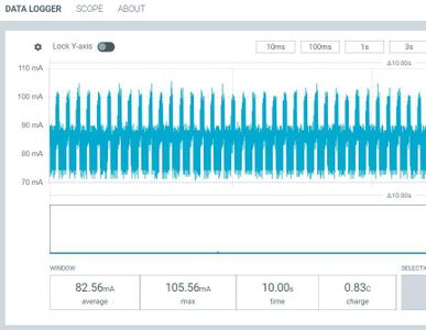

Step 12: Current Test & Battery Life Prediction
To estimate how long the battery will last, I tested the device in two different states and used the Digi-Key Battery Life Calculator for predictions.
  1. Turned Off Condition:
  2. When the device is powered off, it draws only about 1 µA of current.
  3. At this rate, the battery life is theoretically around 108 years! Of course, this is more of an ideal number, but it shows that the device uses almost no power when off.
  4. Turned On Condition:
  5. While the device is running and the display is active, it draws approximately 85 mA.
  6. Based on this current, the battery can last about 11 hours on a full charge.
This means that after fully charging the battery, the device can be used comfortably all day without worrying about recharging. The combination of low standby current and moderate active current makes it very efficient for wearable use.
