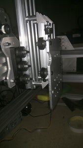

The frame of this plasma cutting table is based on the OX CNC from vslot-europe .
Some profiles were added to rigidify the build and support the machine .

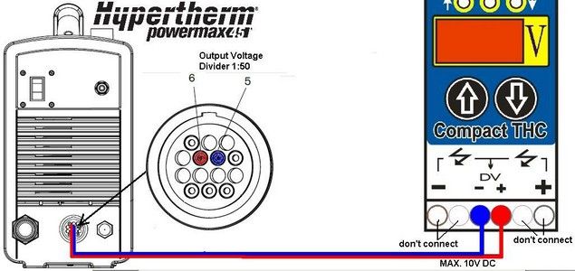

Step 2: Add a THC ( Torch Height Control )
A THC is a nice tool who can help you if you cut big parts .
The THC adjust the height of your torch above your material .
I bought a low cost THC : a Proma THC SD
There is 2 way to do the THC connection
.1 / using a plug on the back side of my hyperterm .( with 1/50 scale )
2 / Directly on the row voltage of the arc I try both , i had some trouble with de 1/50 divider ( voltage was not correct ) so i 'm now using the raw value of the arc and it is much better .

Step 4: Floating Head VS Inductive Sensor
On this build i choose to use a floating head instead an inductive sensor because I was afraid that the parasites created by the plasma arc pertube the operation of the inductive sensor.
You can see above some pictures of the floating head
