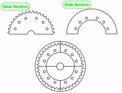

The next and most complicated part is to draw the profiles of the two parts that make up the plasma-sprockets. You will need to know the pitch of the gear as well as the bolt sizes you plan to use.
1. Starting with an already drawn sprocket gear that has an even number of teeth (40 tooth #40 chain in this case).
2. Draw a line down the center of the gear making sure that it goes from one tooth valley to another.
3. Use the center line to trim the gear in half.
4. Starting from a valley on the top side of a gear go down the length of pitch and then draw a circle from the center to meet it.
5. At the 90degree mark go out 1.5 times the pitch length and then down past the circle and then at the 180degree mark go up 1.5 times the pitch length and then to the right past the circle.
6. Use the lines extending past the circle as trim boundaries for the circle.
7. At both ends and the center of the arc left by the trimmed circle create three circles with a diameter equal to the diameter of the bolts to be used plus .005in.
8. Mirror those three holes vertically about the center.
9. You will now need to draw to large circles. The first and larger of the two extends from the center out past the edge of the gears tooth valley the length of the pitch. The second extends from the center up to where the outside diameter of the washers for the bolts will be.
10. Draw a vertical line that bisects the larger of the two new circles.
11. Use that vertical line to trim the two new circles into a crescent shape.
12. Mirror the three bolt holes on the left side of the gear horizontally about the center point.
The end result of this process will be the gear section and side section of the plasma-sprockets design that when put together form a completed plasma-sprockets
NOTE: the rule of thumb for determine bolts size is that the bolt diameter should be close to the roller diameter of the gear (5/16in in this case of #40 gear).

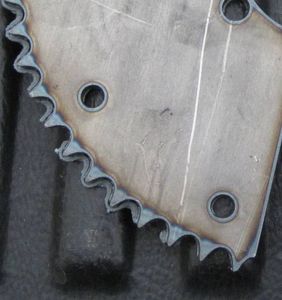

For the first step in turning a virtual plasma-sprockets into a real part, get a hold of a friend or shop that has a CNC plasma table, if you don't have one yourself. Then, set up the machine with the correct thickness of material for creating the needed gear sections and the side sections. Next cut out 2 of the gear sections and 4 of the side section for each plasma-sprockets you want to make.
Notes: I used 1/4in plate for the gears sections and 10GA for the sides sections to create a #40 gear. If you cant find a chunk of material thick enough to create the gear sections, no sweat. Just double up two thinner piece of material. Also the sprocket can afford to be thinner than recommended as the sides keep the chain on track.
Step 4: Cleanup and Paint the Parts
Plasma cut parts, while accurate, tend to have excessive slag buildup, especially on thicker parts. So once the parts come off the plasma table, step one is to grind off the slag. Next check that the hole sizes have not been affected as plasma cutters sometimes have difficulty creating small holes, and enlarging said holes to right size with a drill bit might be necessary. Then for corrosion protection and a little style I suggest adding a nice coat of spray paint.
