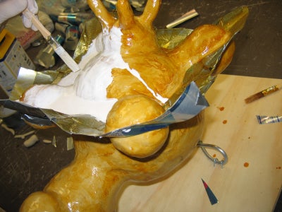

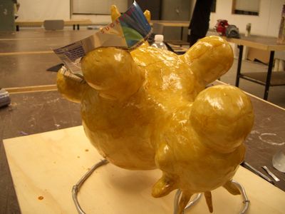

This slide show is going to take you through the process of duplicating a sculpture using a multi part plaster mold. In this case, it was a clay cow getting duplicated in a soft foam urethane. The materials needed include:
  • Plaster
  • Plaster bandages, fiberglass, hemp, burlap, or horsehair
  • Disposable gloves
  • A mixing bucket
  • Trash bags to line the bucket for mixing up plaster
  • Aluminum cans
  • Scissors
  • Duct tape
  • A screwdriver
  • Shellac
  • Chip brushes
  • Pam, mold soap, mold release, floor polish wax, Murphy's oil soap, or liquid vaseline to use as a mold release

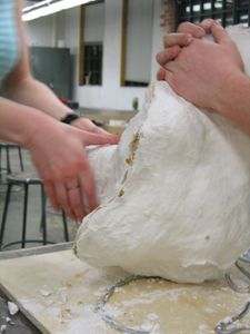

    Hi, cow looks great! next time try embedding some hessian(old jute bagging) or shadecloth , or cut up pieces of flyscreen into the plaster and it helps to strengthen the plaster mold. If you cut strips of old hessian/shadecloth/fibreglass flyscreen, and dip it into the plaster then drape it across the mold sections it helps. For curved shapes, using a triangle shaped piece of mesh fabric works best as it will wrap around a curved shape better. Love the idea of using aluminium cans for shims, great way of avoiding thick shims distorting the final product by making thick ridges on the joints, that have to be sanded down. If you keep your shellac mix in a wide mouth coffee jar with a screw top plastic lid then any leftovers can be kept for future projects. Just make sure the thread of the lid and jar are wiped clean before closing otherwise it will stick so hard you will be cursing when you next try to open the jar. Should this happen use hot water on the lid to soften it and then get a good grip on the lid and strain yourself to open it. This is when a srong handed man is an essential in the workshop! LOL.

    Since the final casting was in soft foam, undercuts weren't a giant concern in this model. I just destroyed the clay model upon demolding. It just fell apart. It's clay, not depleted uranium. It took some cleaning, but every piece of clay came out of the mold.
