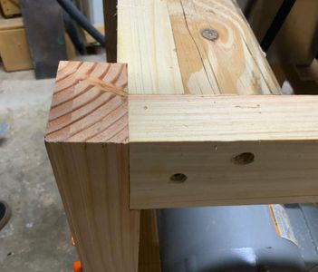

To make fabrication and assembly easier, I added rabbets into this design.

I started by gluing and screwing the 17" long stretches to the Legs first to look like a ladder
After those ladders were put together, it was relatively easy to glue and screw the 11 7/8" stretcher to the ladder assembly.
See attached pictures of how the rabbets worked to help hold everything together.

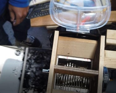

I'm an idiot and used this shredder box without a hopper and I would suggest no one else try this. So I made a quick and dirty hopper box to fit on top of the shred box. See rough sketch for how I assembled it.
I added a hopper which is a pure rough prototype. there is a divider in the middle to keep the plastic from moving to the opposite side of the shredder as it tends to fling plastic up if there is not divider.
The current lid is a Polypropylene or PP take out container. That is very temporarily attached but does make a difference as the plastic tends to jump up out of the hopper if that's not there.
I also have a push stick on the side to help push plastic into that nasty shredder assembly. This machine is very intimidating to me so I'm keeping my hand well away from that box!

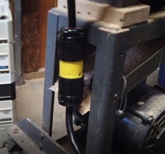

Plug in (I use 220v quick connect plugs to connect motors to my VFD see link to other video for how I wire motors) the motor to the VFD and start using!
One of the special things I have on this VFD is the option to stop, reverser, and forward the motor. This is helpful for this shredder since I often have to reverse the motor to clear up plastic from getting clogged up.
