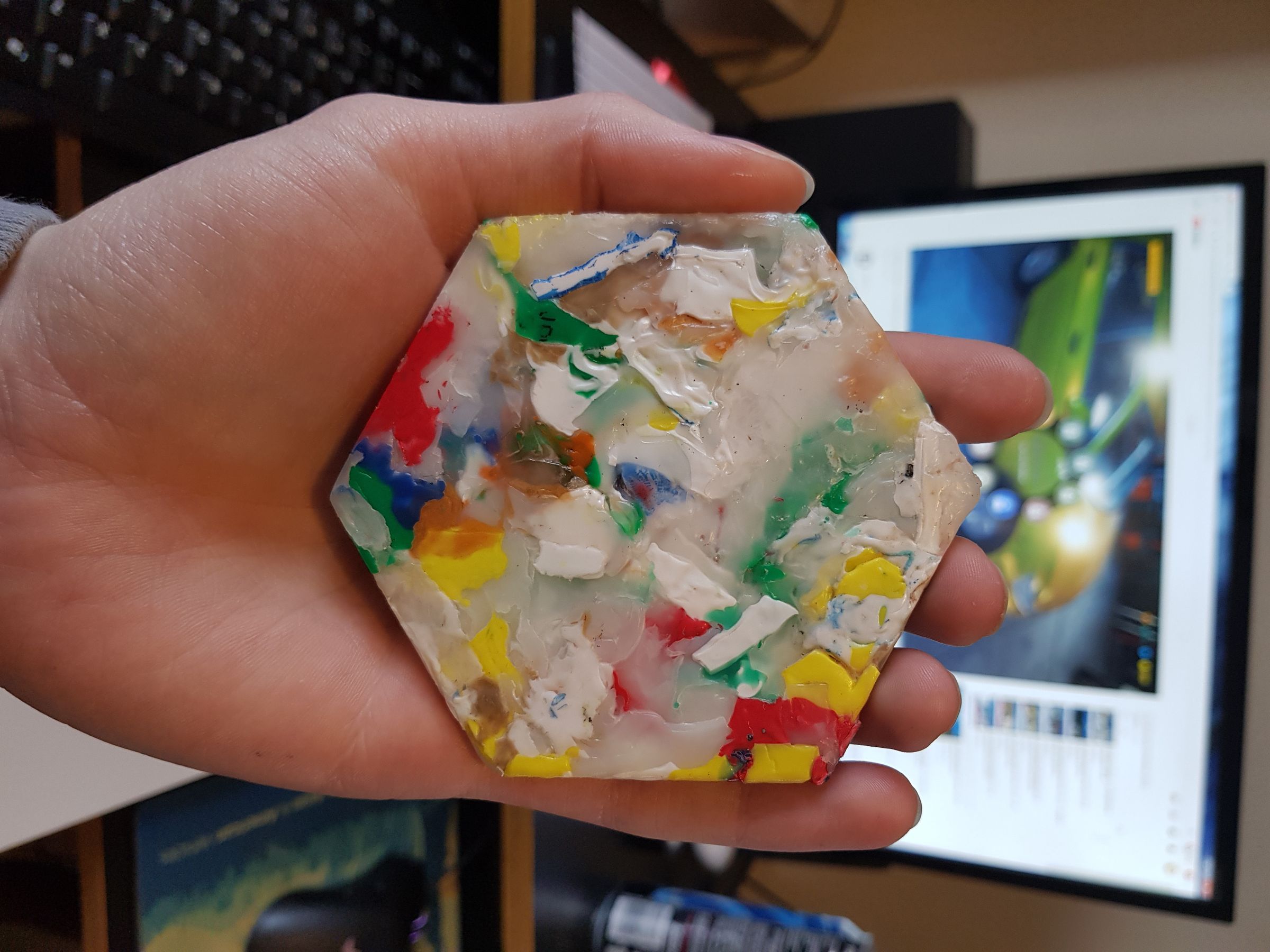

Step 5: You're Finished Piece
Leave your mould to cool for an hour or more depending on how big the plastic item is. There should be a slight amount of shrinkage during the cooling because hot plastic will contract as it gets colder. Take off the clamp and lid and you should be able to remove the plastic easily. As you can see mine came out pretty nicely but sometimes you may need to sand it down or remelt with added plastic if there are areas missing. You can use certain colours and shape the plastic to give it cool effects too. I hope to make some like that and show them in future projects.
