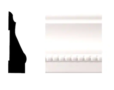

- PVC Casing Molding. You can use different styles. This worked well for me since it lays flat. One piece is 7 feet long, so each one can make 1.25 planters.

For the frame, the box opening is 10-1/2 inch wide x 9-1/2 inch tall. We'd like to have a 1/4 inch reveal all around, so the inside dimensions of the frame are 11 inch x 10 inch. I cut them on a miter saw at 45 degrees with the thick part of the case molding on the outside. Since the molding is 2.25" wide, the outside dimensions are 15.5" wide x 14.5" tall.
