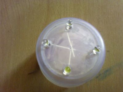

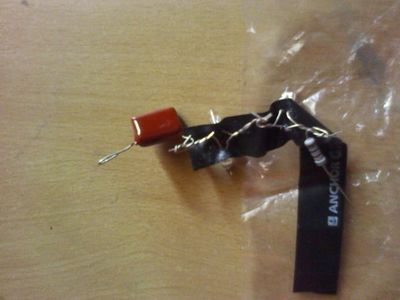

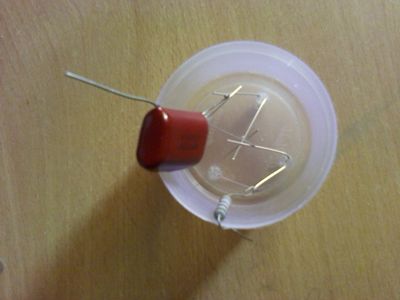

Step 1: Components & Photos!
Components:
1. LEDs - Anywhere from 2 to 30.
2. A ceramic capacitor 0.22 uF (of number 224 K, rated for 400 VAC) if your country provides 220 VAC. Or a 0.47 uF ceramic capacitor, if on 110 V AC Mains.
3. Single resistor of one kilo-ohms, BUT RATED FOR ONE WATT OR HIGHER (Lower wattage resistor will BURN on AC Mains).
4. Waste plastic box, or a container or pet bottle. Or just plain simple electrical tape!
