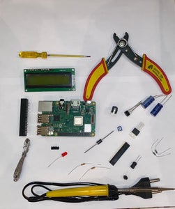

Hardware Specifications:
  • Raspberry Pi 3
  • LCD Display
  • Buzzer
  • Resistors
  • Capacitors
  • Transistors
  • Cables and Connectors
  • Diodes
  • PCB and Breadboards
  • LED
  • Transformer/Adapter
  • Push Buttons
  • Switch
  • IC
  • IC Sockets
  • Full HD Camera with IR sensor

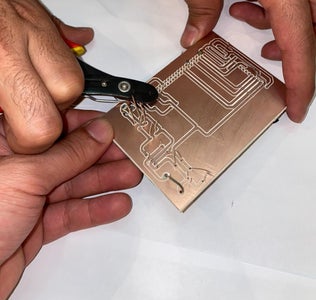

Step 2: Prepare Hardware: Main Mother Board
It should contain power inlet source, along with reset push button. Connect IC Socket to the main mother board and IC to LCD display. Connect Diodes, Transistors, Capacitators, Resistor and LED to make a complete power cycle.

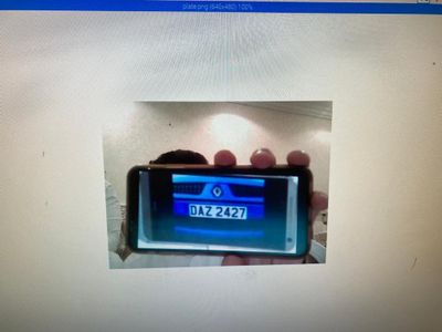

Step 6: Test
Now get a plate number on your phone and place it in front of the camera, it will show the plate number on the LCD screen.
