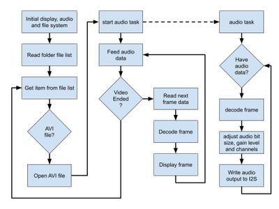

Step 2: Simple AVI Player Design
Above flow chart illustrate a simple AVI Player design. First read file list from a file system folder, loop each item in file list. If it is an AVI file, open, read, decode and play it.
  1. The file system can be SD card or built-in flash LittleFS or FATFS, most AVI video size requires SD card
  2. Decode MP3 audio also a CPU intensive task, so it is better offload to another EPS32 core
