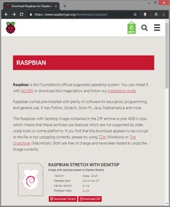

Navigate to https://www.raspberrypi.org/downloads/raspbian/ on your regular computer and download "RASPBIAN STRETCH WITH DESKTOP".

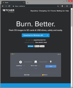

Also go to https://etcher.io/ and download Etcher and install it.

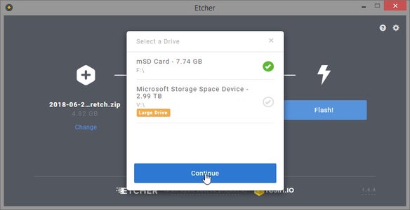

Run Etcher and click Select image and browse to the zip file. Click on Select drive and browse to the microSD card then click Flash!

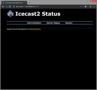

Now to install Icecast2. Type in "sudo apt-get install icecast2" followed by enter. After it installs a window will pop up asking if you want to configure Icecast2. Hit the left arrow key and enter to select Yes. On the second screen hit the down arrow key and enter to select OK to use the default hostname "localhost". On the next three screens hit the down arrow and enter key to agree to use "hackme" as the default source, relay and administration password. Even though we are agreeing to all of the default settings, these steps must be completed to activate the Icecast2 server.

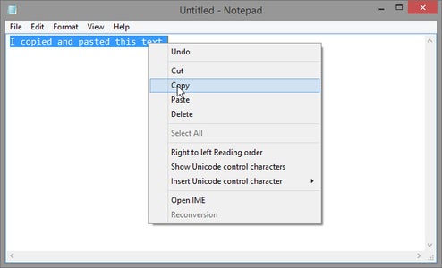

Next we need to run the GUI file manager as root user. To do this, select GUI Menu > Run. Type in "sudo pcmanfm" and hit enter. That will open up the file manager (the equivalent of file explorer for us Windows users) to the home directory (/home/pi) and you will see the leftover darkice installation file we previously downloaded. RIGHT-click in an empty space and select Create New and then Empty File. Name it "darkice.cfg" and click OK. Then RIGHT-click that newly created file and choose to open it with Leafpad (the equivalent of Windows notepad). Copy the lines below and paste them into Leafpad then click File and Save. You'll notice the "quality" line is commented out with a # in front of it. It is used only if you set "bitrateMode = vbr" (variable bitrate). You can't have a quality value set when using cbr (constant bitrate) or the stream will stutter and skip. Conversely, if you decide to use vbr then you need to comment out the "bitrate = 160" line and uncomment the "quality" line.
NOTE: The highest quality mp3 bitrate you can have is 320 kbps; however, both the WiFi and Bluetooth radios on the Raspberry Pi are on the same chip so if you max out the bandwidth of both, bluetooth audio can stutter or freeze. We are going to be changing a setting later that will remedy this however it limits the WiFi bandwidth somewhat so I reduced the audio bitrate for this project to 160 kbps since I plan to keep it on WiFi exclusively. If you are using ethernet it is not an issue and you can safely set the bitrate to 320 kbps.

sudo service icecast2 start

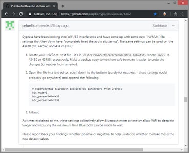

Both the WiFi and Bluetooth radios on the Raspberry Pi are on the same chip so if you max out the bandwidth of both, bluetooth audio can stutter or freeze. Some call it a bug and some say it's just a hardware limitation. We are going to be changing a setting that will remedy this. The credit for posting this fix goes to "pelwell" at https://github.com/raspberrypi/linux/issues/1402 Run sudo pcmanfm again to open the file manager and browse to /lib/firmware/brcm. Double-click the text file "brcmfmac43430-sdio.txt" to open it and add these lines to the bottom and save.
# Experimental Bluetooth coexistence parameters from Cypress
btc_mode=1 btc_params8=0x4e20 btc_params1=0x7530

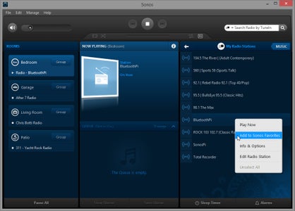

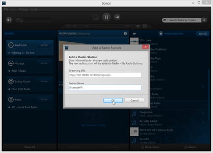

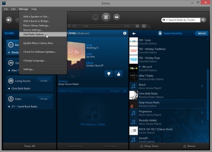

You must use the Sonos desktop controller app to add a custom stream to Sonos. Click on Manage > Add Radio Station and enter the url for the stream which in my case was "http://192.168.86.107:8000/rapi.mp3". Also enter a Station Name and click OK.
Step 21:
To play the custom radio station we just added, select "Radio by Tunein" and then "My Radio Stations". LEFT DOUBLE-click to play or RIGHT-click to edit or add the station to your Sonos favorites.
Step 22:
After adding the custom radio station it will immediately be available in your Sonos app. Open the app, tap "My Sonos" at the bottom, scroll down to "Stations" and tap "See All". Scroll down until you see your newly created station. Tap on it and it will start playing in your selected rooms. ̶R̶e̶m̶e̶m̶b̶e̶r̶,̶ ̶i̶f̶ ̶y̶o̶u̶ ̶d̶i̶s̶c̶o̶n̶n̶e̶c̶t̶ ̶y̶o̶u̶r̶ ̶b̶l̶u̶e̶t̶o̶o̶t̶h̶ ̶f̶r̶o̶m̶ ̶t̶h̶e̶ ̶P̶i̶ ̶t̶h̶e̶n̶ ̶t̶h̶e̶ ̶I̶c̶e̶c̶a̶s̶t̶ ̶s̶t̶r̶e̶a̶m̶ ̶w̶i̶l̶l̶ ̶d̶i̶s̶c̶o̶n̶n̶e̶c̶t̶.̶ ̶I̶f̶ ̶y̶o̶u̶ ̶s̶w̶i̶t̶c̶h̶ ̶a̶u̶d̶i̶o̶ ̶a̶p̶p̶s̶ ̶i̶t̶ ̶m̶a̶y̶ ̶d̶i̶s̶c̶o̶n̶n̶e̶c̶t̶.̶ ̶T̶o̶ ̶r̶e̶s̶u̶m̶e̶ ̶l̶i̶s̶t̶e̶n̶i̶n̶g̶ ̶o̶n̶ ̶S̶o̶n̶o̶s̶ ̶y̶o̶u̶'̶l̶l̶ ̶h̶a̶v̶e̶ ̶t̶o̶ ̶r̶e̶s̶t̶a̶r̶t̶ ̶p̶l̶a̶y̶i̶n̶g̶ ̶a̶u̶d̶i̶o̶ ̶o̶n̶ ̶y̶o̶u̶r̶ ̶p̶h̶o̶n̶e̶ ̶a̶g̶a̶i̶n̶ ̶A̶N̶D̶ ̶p̶u̶s̶h̶ ̶p̶l̶a̶y̶ ̶o̶n̶ ̶t̶h̶e̶ ̶S̶o̶n̶o̶s̶ ̶a̶p̶p̶ ̶a̶g̶a̶i̶n̶.̶ <---This has been fixed; see update below. Good luck and thanks for reading!

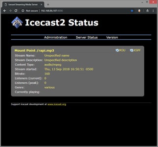

Open the File Manager as root using "sudo pcmanfm" and browse to "/etc/icecast2". RIGHT-click on "icecast.xml" and open using Leafpad and paste these lines just under the top "<icecast>" line:
<mount> <mount-name>/rapi.mp3</mount-name> </mount>
Save and Reboot and you should now be able to start your custom Sonos bluetooth station before you've even connected your phone to bluetooth!
