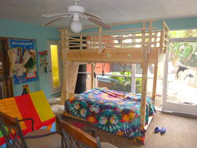

Step 1: Mattress Base Assembly.
Just a big frame screwed together.
Step 2: Upright Posts for Top Level.
The pictures give an idea of what I did. Basically, I made a big cube. I just kept adding wood spans and screwing 2x4 's until it was stable and the flex was minimal. It turned out kinda like a big bunk bed.
Step 3: Finished Top and Fun Stuff Added.
I used 2x4's and 1x2 strips to make top railings. I wanted a certain level of security up there since a 2.5 yo would be using this. After looking at the raining and her up there I went a step further and tied rope in the corners, kinda like a web, to give her a bit more security. I added foam pads to the top floor area and cut foam pads to fit in areas where heads might hit the wood. I added a little pulley arm for the kids to play with. Also a coconut head to use as a pull bucket. There is a climbing board and a trap door that swings up on the top floor area.
