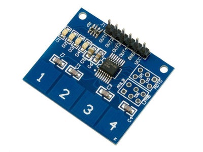

  • Small Keyboard (Or any other keyboard) in our case we are using a touch keyboard with 4 keys.

  • Connect Arduino digital pin 2 to Keyboard Pin [Out1]
  • Connect Arduino digital pin 3 to Keyboard Pin [Out2]
  • Connect Arduino digital pin 4 to Keyboard Pin [Out3]
  • Connect Arduino digital pin 5 to Keyboard Pin [Out4]

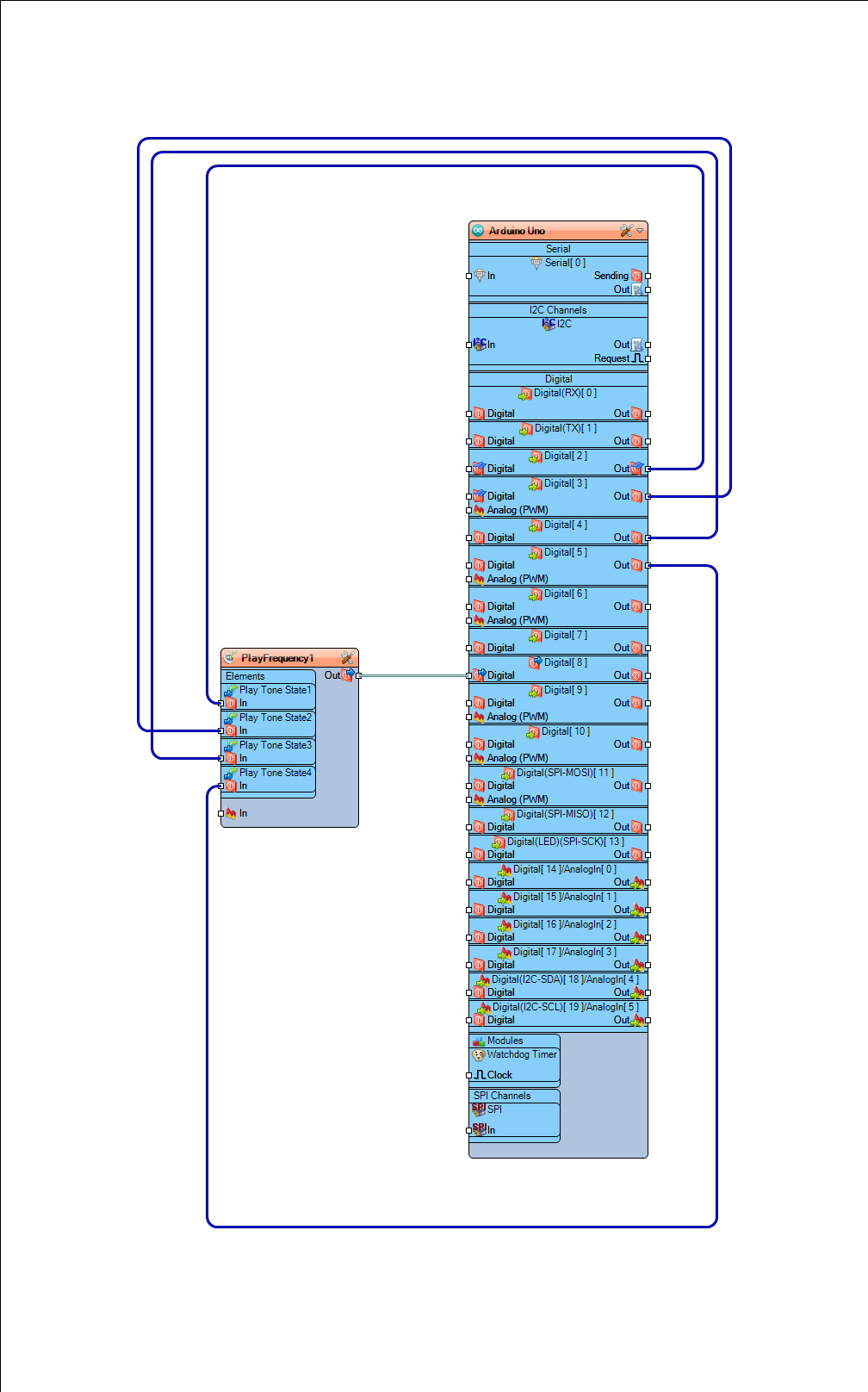

Start Visuino as shown in the first picture Click on the "Tools" button on the Arduino component (Picture 1) in Visuino When the dialog appears, select "Arduino UNO" as shown on Picture 2

  • Add "Play Frequency Tone" component

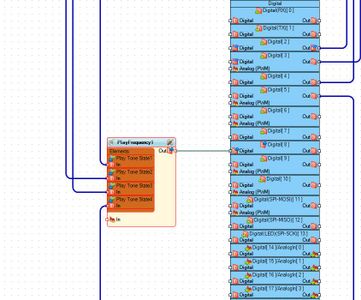

  • Double click on the "PlayFrequency1" component and
  • In the Elements window drag 4X "Play tone state" to the left side, and for each one in the properties set a diferent frequency: 260, 290,330,350
  • Or set some other frequencies that you prefer.
  • Close the Elements window.
  • Connect Arduino Digital pin 2 [Out] to PlayFrequency1 > Play Tone State1 pin [In]
  • Connect Arduino Digital pin 3 [Out] to PlayFrequency1 > Play Tone State2 pin [In]
  • Connect Arduino Digital pin 4 [Out] to PlayFrequency1 > Play Tone State3 pin [In]
  • Connect Arduino Digital pin 5 [Out] to PlayFrequency1 > Play Tone State4 pin [In]
  • Connect PlayFrequency1 pin Out to Arduino Digital pin 8 [In]
