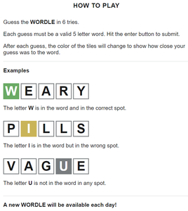

The game is called WORDLE, you can play it online here. It's an online word game, with a new puzzle every day. You have 6 chances to find a five-letter word, in English. After your guess, the color of each letter indicates whether it is well placed (green), it exists but in another spot (yellow) or it is not in the word (grey). You can see the rules up there.

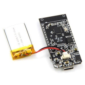

  • One ESP32, possibly TT-GO T-display for a more graphical version.

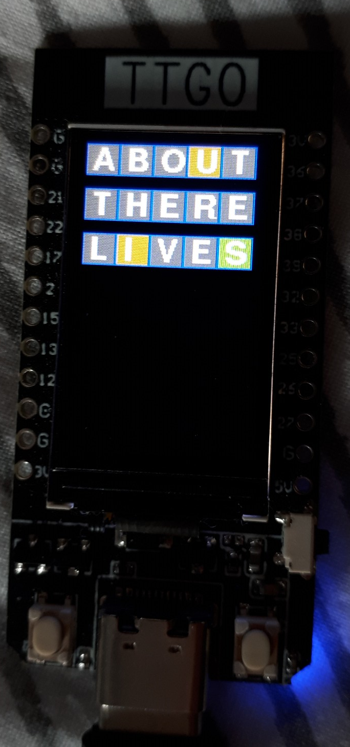

Step 2: Graphical Version
I also wrote a graphical version of the game, which mimics the original interface on the TT-GO T-display. To use it, you need the files below. Create in your Arduino folder a new folder called 'Wordle_TTGO', and do the same as explained above (data folder, dictionary files, upload, etc) with the additional 'Free_Fonts.h' file (which goes in the 'Wordle_TTGO' folder).

Here is another game, that goes with the photos:
Please enter a 5 letter word.
ABOUT
THERE
LIVES
Here is what you know so far...
Well placed: ----S
Not in the Wordle: ABEHLORTV
QUITS
AZERT
This word is not in my dictionary, try again
QUIPS
Congratulations, you found it in 5 trials!!
