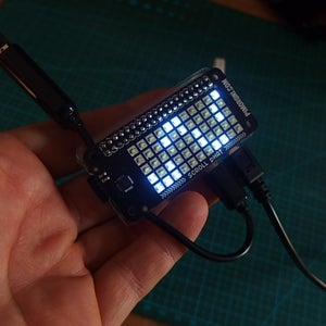

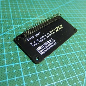

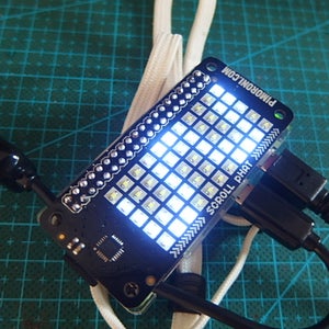

I have also discovered a small led matrix 11x5 by Pimoroni, the pHat. This is a small and pretty led matrix that with this little pretty Raspberry Pi, the Raspberry Pi zero, make a very kindly object. A led scrolling led matrix, that you can program in Python.

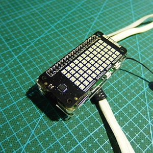

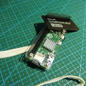

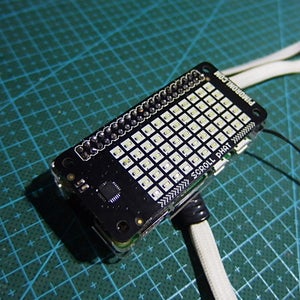

After the soldering step, you can connect the pHat to your Raspberry Pi zero.

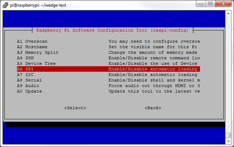

In the Terminal window, type:
sudo raspi-config
put the password (default is raspberry)
1. Go to Advanced Options
2. Select i2c
3. Enable the i2c port

Step 2: Connect the PHat and Try the Code
You can download the three files on your Raspberry Pi. The graph file generate a random lines on your pHat, the tempCpu, show the CPU temperature of your Raspberry Pi zero, and the meteoShare.py show the local meteo condition.

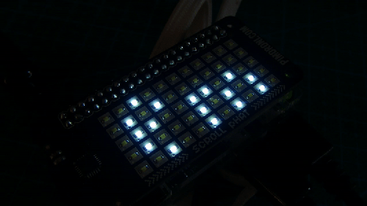

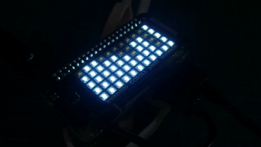

Step 3: Try to Make the PHat Sparkle
In the Terminal window, go to the same folder where are graph.py file, and type:
python graph.py
or
python3 cpuTemp.py
or
python meteoShare.py
See the result!
