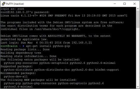

Open a SSH session (follow this instructable if you don't know how to do)
Install Python by typing the following command on the SSH window:
apt-get install python-pip
Install the LiveStreamer software by typing the following command:
pip install -U livestreamer

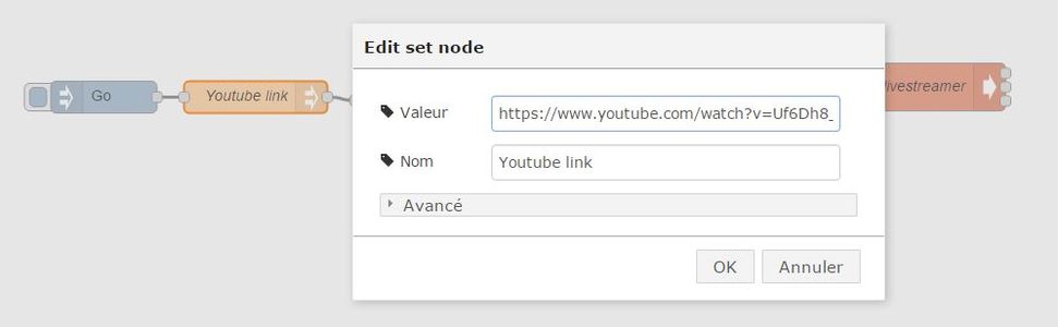

Let's start with the node containing the Youtube URL.

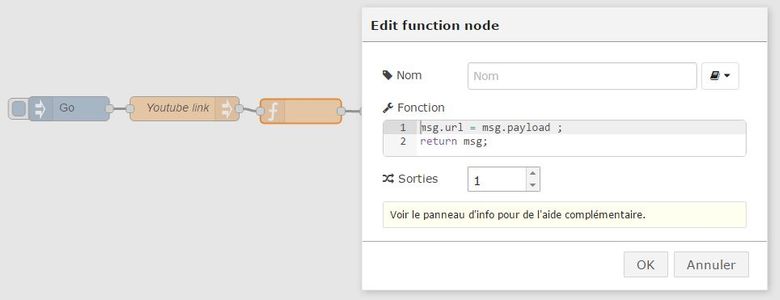

Then a function putting this url in msg.url:
msg.url = msg.payload ;
return msg;

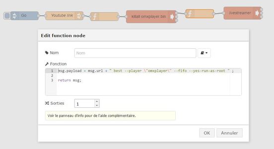

Then, we build the command in a small function:
msg.payload = msg.url + " best --player \"omxplayer\" --fifo --yes-run-as-root " ;
return msg;

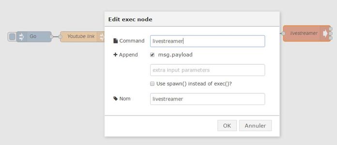

And finally, we launch livestreamer. Don't forget to "append msg.payload" in the command window (this will add the complete argument previously calculated to the livestreamer command)
