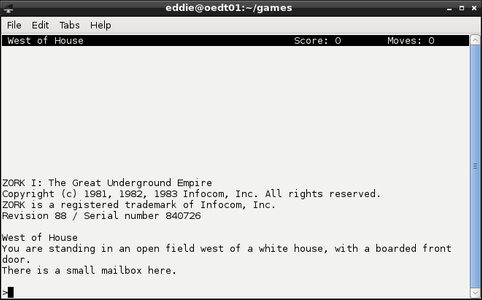

Introduction: Play Zork and Other Zmachine Files on Linux.
Sort of miss the old text adventures where you were allowed to use your imagination. This instructable uses what is known as the zmachine. There are a ton of zmachine games out there. Just use your web search engine to find them. In this case I will at least get you a zork starter file.

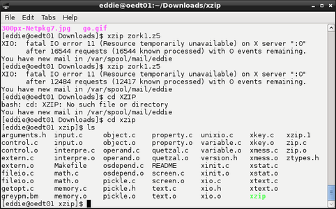

Extract the files.
$ tar zxvf xzip182.tar.Z
change to the source directory
$ cd xzip

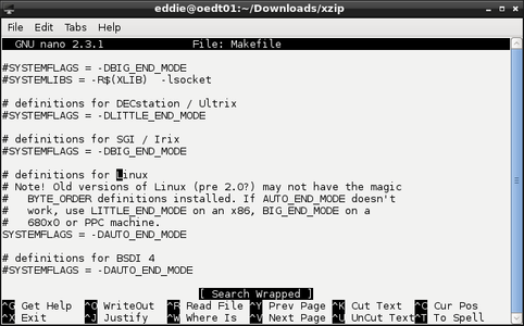

Edit Makefile
$ nano Makefile

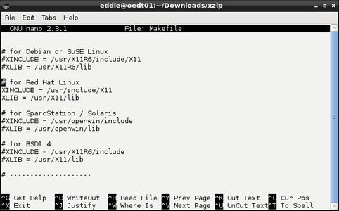

You will need to uncomment three lines. Scroll down to where you see your linux distro.
Uncomment "SYSTEMFLAGS = -DAUTO_END_MODE"
Uncomment the last two lines for your version of linux (i used redhat for fedora).
Save your work and exit.
Now we need to compile the code.
$ make
The we need to install it.
$ sudo make install
$ sudo install -s xzip /usr/local/bin
$ sudo install xzip.1 /usr/local/man/man1
That should be it if all went well.

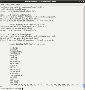

Step 4: Running From the Command Line.
usage: xzip [options...] story-file
or
You can get help with:
$ xzip -help
XZip - a Z-machine interpreter.
Version 1.8.2 by Andrew Plotkin (erkyrath@eblong.com).
Based on ZIP Version 2.0 by Mark Howell.
Plays Z-machine files of versions 1-5 and version 8.

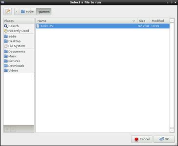

Step 5: Making a Gui Loader.
You will need to create a shell file called xzip.sh
xzip.sh
[code]
szAnswer=$(zenity --file-selection --title="Select a file to run")
xzip $szAnswer
[/code]
Then, you need to copy the file to the desktop if you are running lxde, otherwise you need to make an applet.
To start the program double click the applet and choose the file to run.
That's it!
