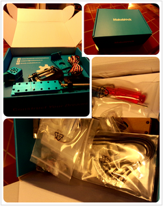

Recently I get a surprise gift from my friend in Makeblock. Just open it, duang duang!!~O(∩_∩)O~

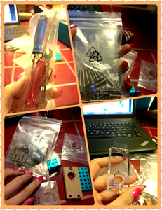

It’s a blue box, similar size with shoe box, dual floors, placed some blue aluminum hardware, boards, tools, screws, cables...
Ok, it’s a drawing robot called mDrawBot!

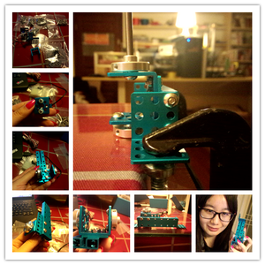

Step 2: Assemble - Pen Lift Mechanism

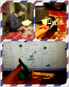

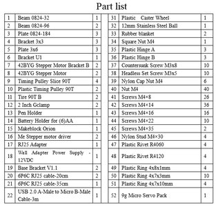

Now I get my hands ready to build this little robot. I received a step by step assembling manual which is quite clear as well. mDrawBot can be assembled into 4 configurations, each named as mScara, mSpider, mEggbot and mCar. I decide to start with mScara.
I did some research, the SCARA acronym stands for Selective Compliance Assembly Robot Arm or Selective Compliance Articulated Robot Arm, so I think mScara is a drawing robot arm.
The first part is the Pen Lift Mechanism, which is a common part in 4 configurations. I find out components I need, and made it succesfully, how exciting! What I need to do is put things together with screws, and a robot will come out! ~\(≧▽≦)/~

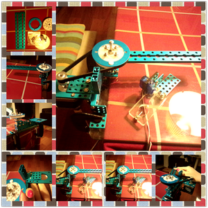

Step 3: Assemble - Base Support
The second part is the base support. I have to be very carefully to assemble those blue aluminum parts. I made some mistakes can doubled the time to fix it. But after one hour I did it. It’s amazing to see pieces became parts of a robot. I’m dying to see how this work. ^_^

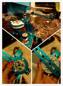

Step 4: Assemble - Arm
Metal beams, plates, wheels, motors, screws, one more hour and I finally finished the assembling.

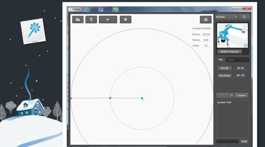

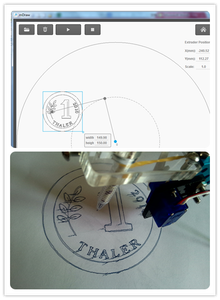

Here I use the software mDraw to control this robot, mDraw is designed for mDrawBot by Makeblock.
It’s a quite friendly software, no setups. Choose port to connect, click “update firmware” button, and then open a SVG picture to draw it out.

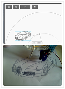

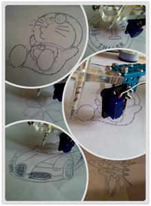

I started with some samples provided together with this robot. Here is my first work.
Step 7: Keep Drawing
mScara did it’s work but it’s not very good this time. So I tightened some screws, and choose a car and a coin to draw.
Lines and circles looks good, however, the pen left lots of traces when it’s lifted and put down which is annoying. I think I might put the pen too low, so I adjust the position of pen.

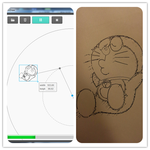

Step 8: Hello, Doreamon~

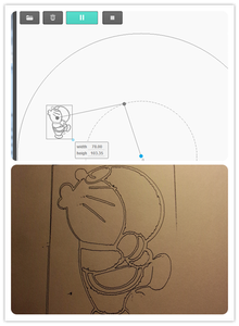

I download somepictures online and convert them into SVG files with a online tool. The quivering lines is not because of robot, it’s just how the picture turns out. Wish I can find a way to fix those converted file.
Whatever, hello Doreamon~ I finally got you~ It takes around 7 minutes to draw a Doreamon, it’s soooo cute. ^_^
