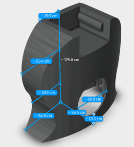

Skip to Step 3 if you already have files. You can have dimensions by using an actual ukulele or buying a plan, but I used Solstie's 3D models for my dimensions.

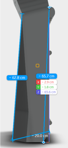

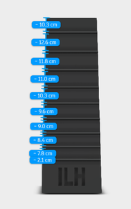

The very first thing you need to have when starting from scratch is dimensions. When viewing an stl file, you can use the measuring tool to measure the 3d model. Make sure to write your measurements down somewhere to keep track. Cut the dimensions into four parts, top/bottom neck and top/bottom body (cut below the sound hole for the body). I recommend also measuring your pegs and screws to make holes more accurate, you need the holes to be just slightly bigger (I used around 5mm) or else fitting the pegs/screws would be difficult. You can also sketch some designs to add on your ukulele during this step. A soprano ukulele is 58 cm tall with 12-15 frets. My project is 48.5 cm tall with 12 frets so it's on the smaller side.

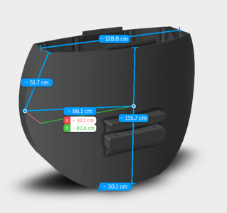

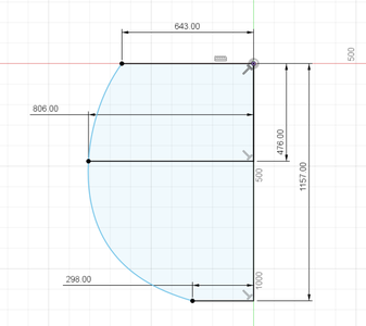

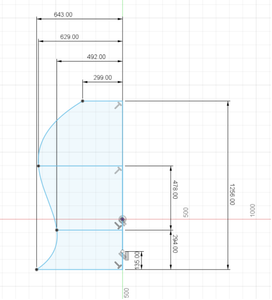

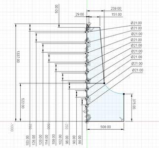

The units in the picture is in mm, but the actual print has to be 0.1x smaller. I had to scale down each model to 10% after I realized this. The actual measurements would move the decimal 1 to the left in mm (ex: 1256.00 mm -> 125.60 mm)

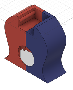

You can now use your dimensions to CAD your own soprano ukulele. I used Fusion 260. I recommend you to CAD the pegs to help adjust the holes in the neck, as well as the screws to make screwing easier. Screwing through the ukulele without holes can be done (as seen in Soltie's version) but it's difficult and has the potential to break your print if you aren't careful (see Step 6). You can utilize the mirror tool to make things easier. You can add your designs on the 3D model during this step, just don't mess with the frets, holes, and bridge of the ukulele.
For the neck parts I started with the side profiles because it was easier to extrude them wide than thick. After extruding I used sketch and extrude to add the headstock. I used the extrude cut tool for the holes, nut, and fret markers.
For the body parts I divided them in half and used the mirror tool to mirror the sketch. After that I added the bridge with extrude and made holes using extrude cut.

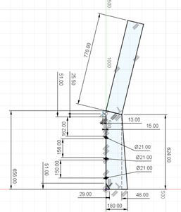

After making this project, one problem I had was the headstock blocking my hand from pressing frets closer to the nut. I recommend leaving some more space on the part here the headstock connects to the neck to fix this problem (as seen on 6th pic).

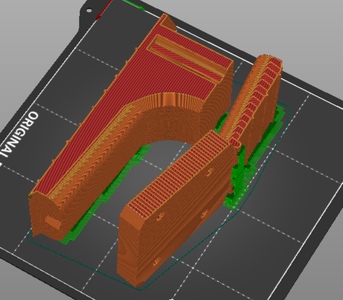

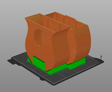

Slice the model using a slicer. I used Prusa Slicer to slice mine. You can add supports to help with print quality but it's not really needed. I suggest not adding supports around the bridge as well as indents and holes because it may be hard to remove the supports in those areas. You can fit two bodies at the same time (as seen on the pictures above). Use 50% infill to shorten the time and resources used while still having a durable ukulele. You generally want to position the bodies to have the least amount of support possible. For my model, I positioned the necks facing sideways and the top base upside down.
Print Settings: 0.25mm DRAFT
Detect bridging perimeters enabled
Fill density: 50%
Generate support material enabled
Filament: Generic PLA
Nozzle temp - First layer: 230C; Other layers: 230C (necessary for the filament I used)
Printer: Orginal Prusa MINI & MINI+
I used the same settings for both neck and body parts
I also put support blocks on the sound hole, bridge, the holes on the headstock and the frets (seen on pictures above)

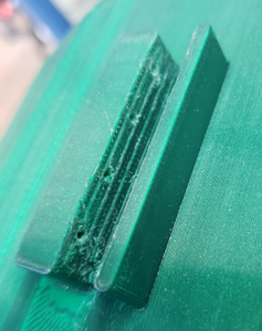

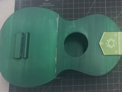

After the print you will have some supports and some rough edges. Clean up your print using the tools you have. Some important parts to clean are the holes on the bridge and the nut on the neck, especially if you used supports on those parts (shown in pic 1, I had trouble cleaning out the holes on the test print since the supports were in a weird spot). After you're done, you can glue the parts together using super glue. You can keep the parts together to dry using tape to make it easier. It's very important to glue the parts properly and store it in a safe place when drying because it can affect its playability. The best way is to lay it upright to dry so that the neck can stay upright. Make sure it's fully dry before doing anything else.

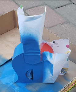

Step 5: Paint (optional)
You can paint before gluing the ukulele together, but I don't recommend it. Gluing first will make both painting and gluing easier.

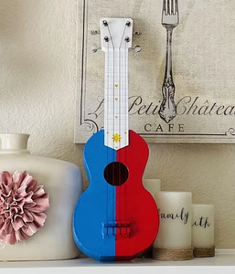

You have the freedom to paint the ukulele however you want, just be careful about the frets and holes, they're needed for playability. I suggest getting help from someone who knows how to paint (example: mom). The way we painted it is by masking off the parts where we didn't want paint with tape and paper. Then we spray painted the parts that weren't masked. For small indents like the sun and stars in my design, we used a small paint brush. You can see in the picture that we painted first before assembling but we later found out that we needed the lines to line up in the middle so we painted over it again after gluing the parts together.

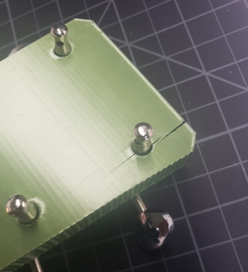

Be careful when screwing without holes, I managed to crack my test print because I was brute forcing a screw into the headstock (see 3rd pic). Work smart not hard, make pilot holes in your headstock for screws before screwing.
