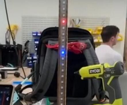

You will need to find an image of a keyboard that will be appropriate for your project. I’ve provided an example. Then you will want to create the physical box dimensions using the MakerCase website. For this, consider your light source. My light strip had just over 1.3 inches between light strips and so I needed my box to accommodate about 17 inches to fit all 13 keys of the piano in width-wise. This is more important when you take both your keyboard image and your MakerCase dimensions into Adobe Illustrator to design your box. In here, you need to scale your box to the ruler tool in the Illustrator program. You should then add circles to be cut out and whatever other designs you want. Upload this design into your laser cutting program and follow laser cutter procedures.
Step 4: Assemble Your Box and Align Your Light Strip
Once I laser cut the box, you will need to glue it together. I reinforced the inner edges of my box with smaller pieces of scrap wood that I found would provide more glued-on surface area.
After gluing, you will want to tape on the light strip in the appropriate position. After this, you will want to find a comfortable position for your Bluefruit disk and external hardrive to sit while you operate this now-functioning Player Py-ano!
